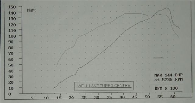

Had a look at the power plot in the link above and something is not right. Torque and power cross point are not at 5252rpm (below)
This is mine for a standard efi pinto with just the turbo added at 7psi. Only ran up to 5800rpm on this plot. Did another run to 6500rpm and got 174bhp but no print out.

so what does that mean?
and right the turbo is maxed out the fueling according t my AFR gauge is showing 14.5 on full throttle at just under 5000RPM 0.35-0.4 bar boost
is that ok , next is the 5th injector but shes is going very well in the vids i am only going to 4K rpm to be safe ,, what you think
and also for 160 quid that AFR gauge is bril i well recommend it over ANY other gauges i have seen so for for the price came with evrything i needed to install and a bosh laba wideband sensor
is that not running a extra injector then? as thats what im doing and i have pretty much maxed out the fueling now at about 6 psi

From: Teesside
No extra injectors on mine.
