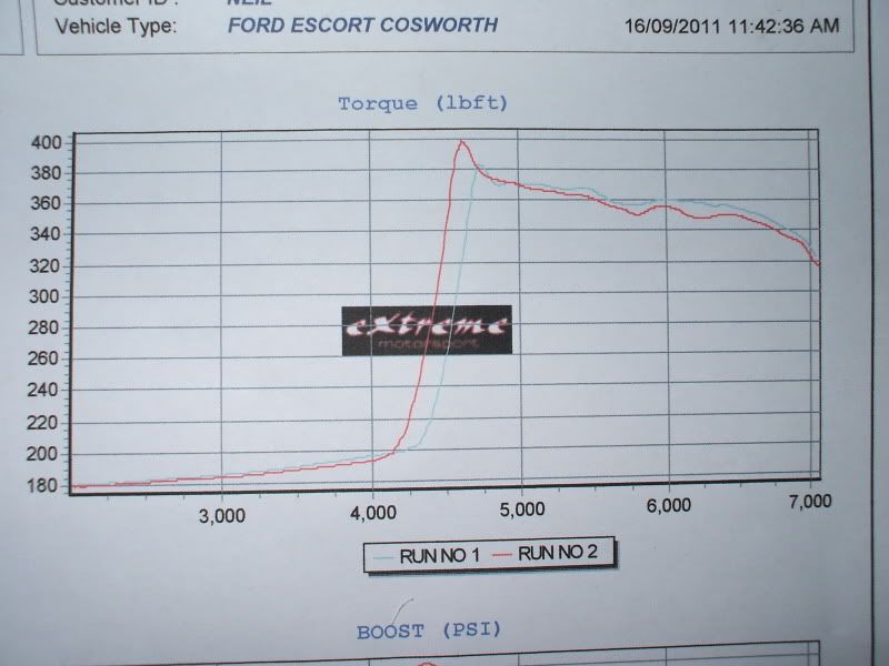

Just found the roller graphs in the glovebox so here are a couple of pics as i dont have a scanner. Im not sure if the rollers loaded the car up fully low down as im sure the boost comes in a bit earlier on the road.

That must give you a big shove in the back around 4200RPM

The way the car drives on the road is different to how the graph shows, i wasnt there for the run but it looks like they held back untill after 3000 rpm before stamping down.
If Simon from Sitech sees this he may be able to comment better.

It loaded up very well to hit almost 36psi
Mine only made a peak of 31.5psi on the RR, but held just under 30psi from 4500 to 7000
Steve

Steve I know it made the peak boost i would see on the road , just looking at the graph it is like he held back a little untill around 3K revs then stamped down. I dont feel like the power comes in with a big hit on the road if anything the power feels smother than it did on the T34.

Our graphs are almost identical upto 4500rpm, and i know mine was foot in the carpet from the start.
They always drive different on the road to what the graph shows
Steve

Hi Neil, sorry about catching you on Sat. You found the graphs, good.
Your car drives very smooth, I like to tell people that my Grandma could drive your car, its so easy and refined.
The dyno plot is a true representation of the power delivary, you have to bare in mind that on the road that power hike does have to shift a 1.3 ton car, so feel less.
If we had acess to the boost map then we could spread the delivary out some. I also feel some increased duration on the cams would also help spead the power curve. But why????? car drives perfect
Simon.
