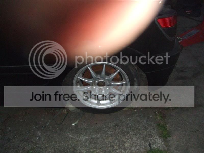

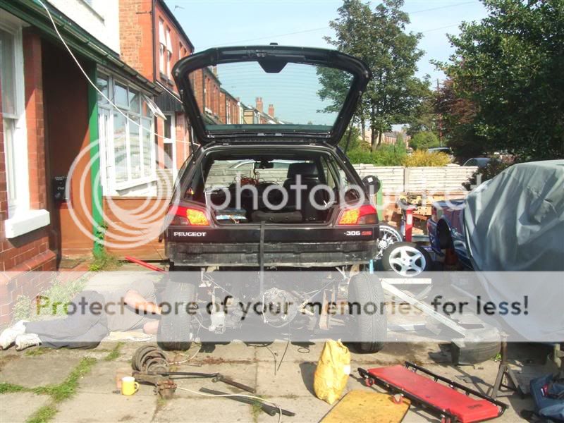

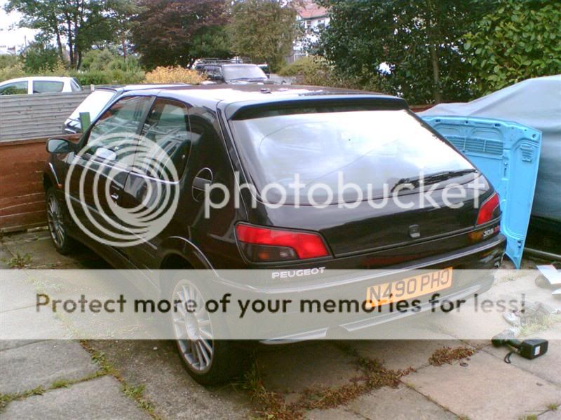

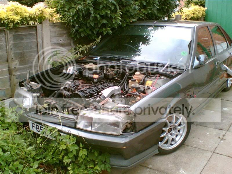

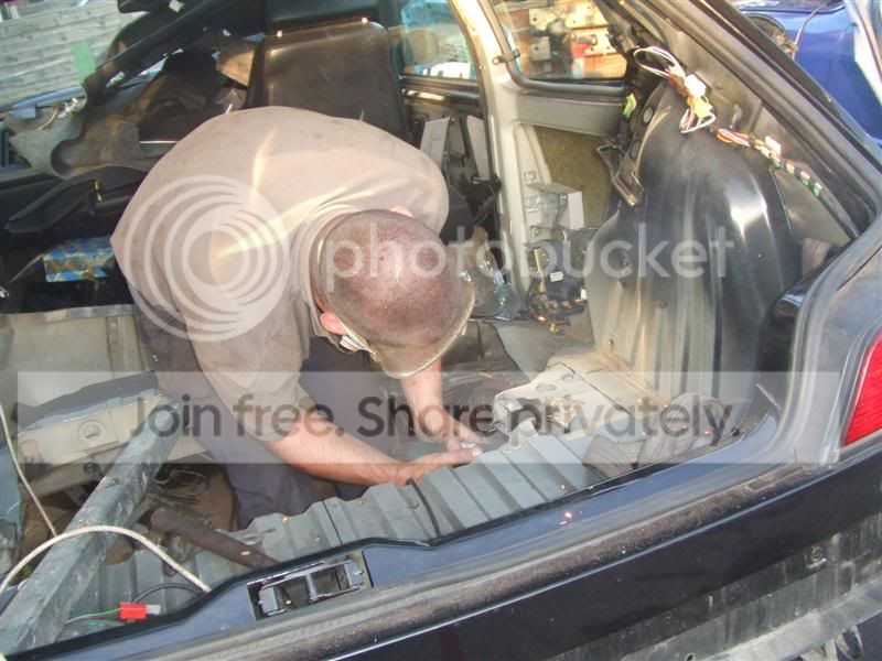

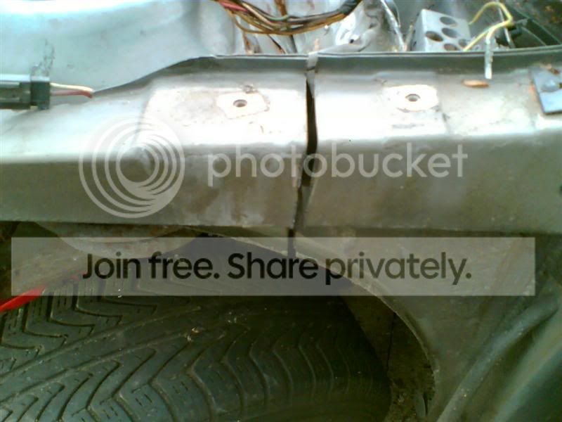

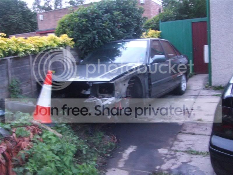

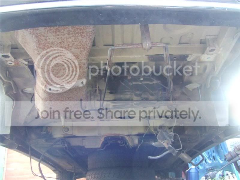

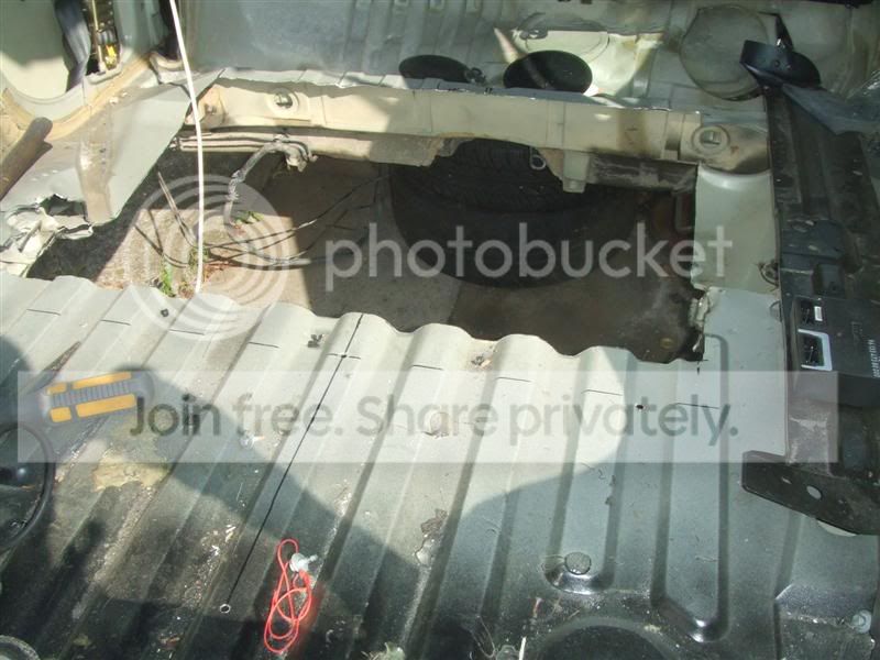

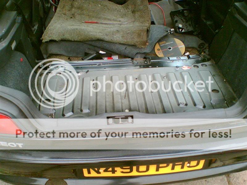

After buying this on ebay over a year ago....I decided it was about time I got my arse into gear & did something with it....
https://passionford.com/forum/viewto...890&highlight=

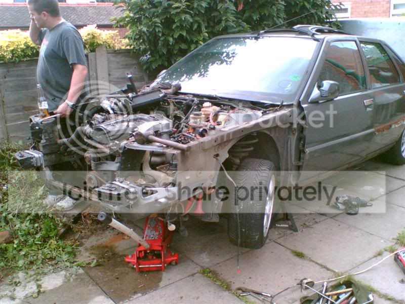

So myself & Nutter made a start yesterday.....

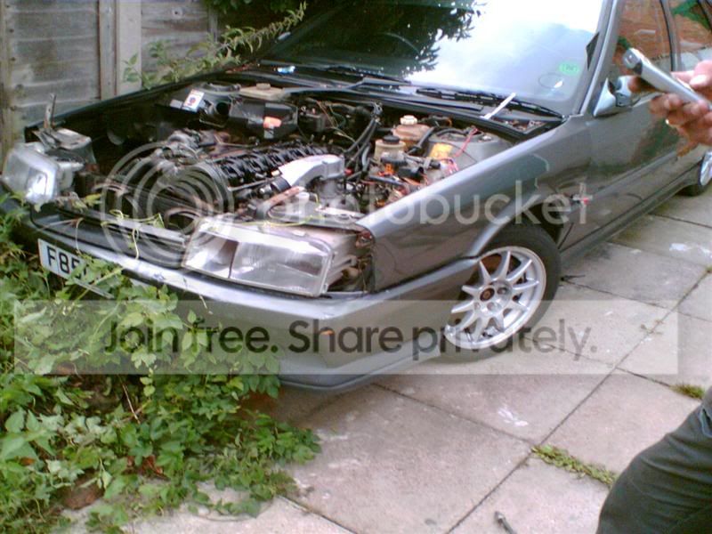

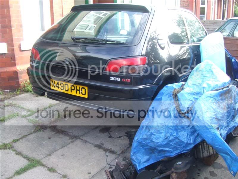

What do you get if you cross a Peugeot S16 shell....
...with an MOT failure Renault 21 Turbo....
...ok ok I'll give you a hint....
Now do you get it......Rear Wheel Drive 21 Turbo Engine Powered Peugeot 306 of course!!!!

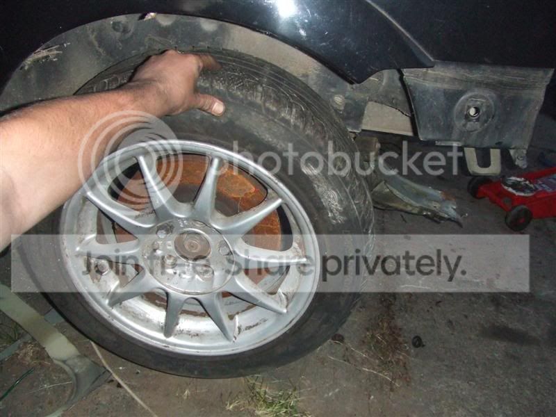

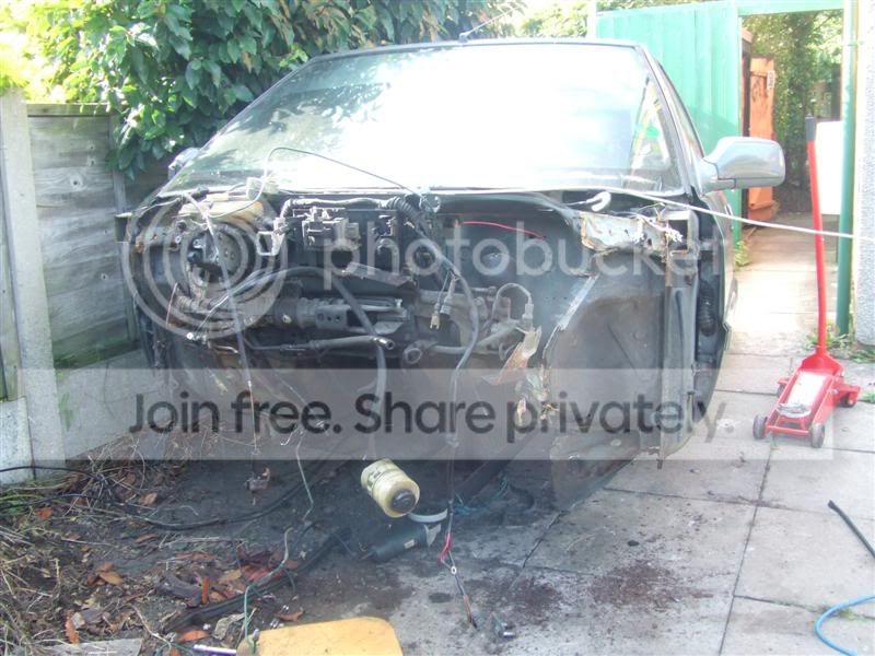

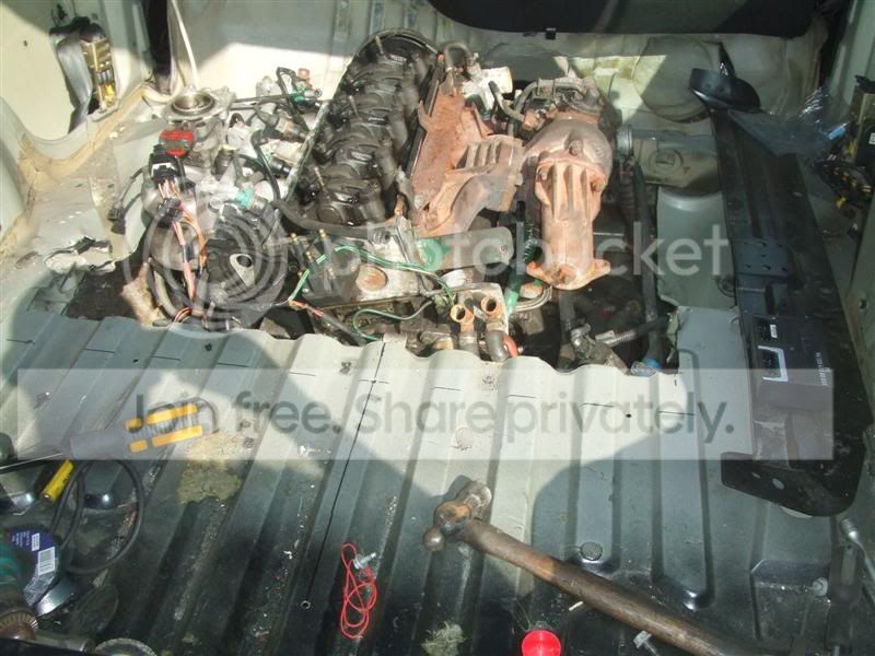

Couple more pics of progress yesterday...
Should be interesting once finished - its all going to be done on a budget so no blingy bits etc.
Hoping to have a few more bits cut out after tomorrow & lined up in the Pug!!!

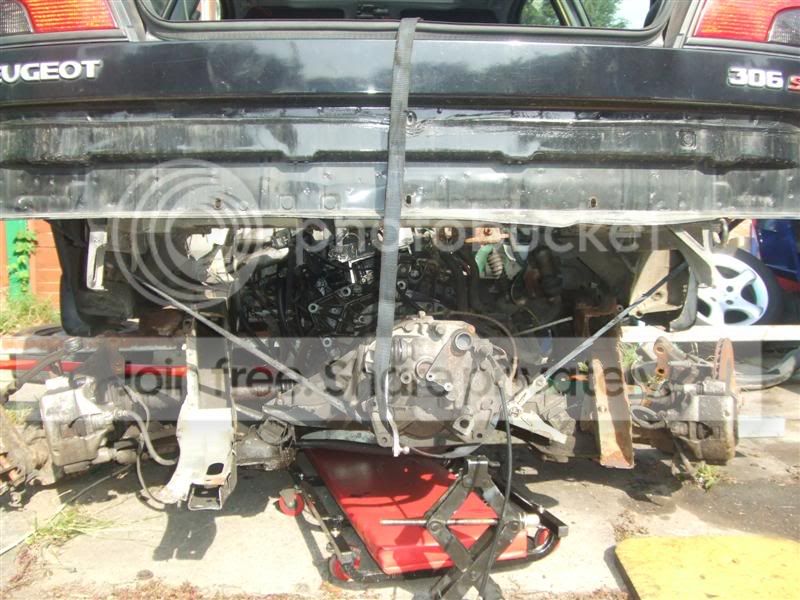

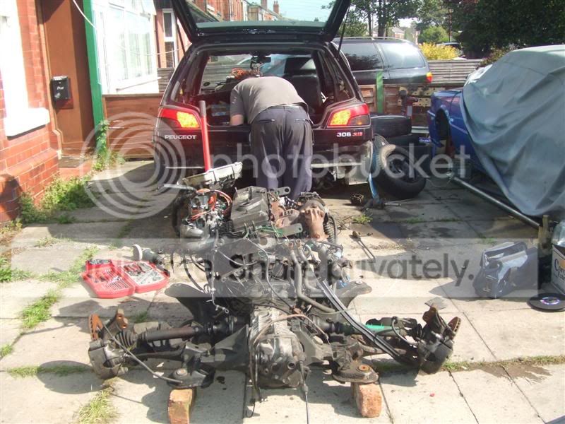

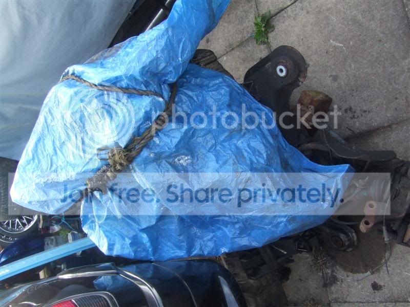

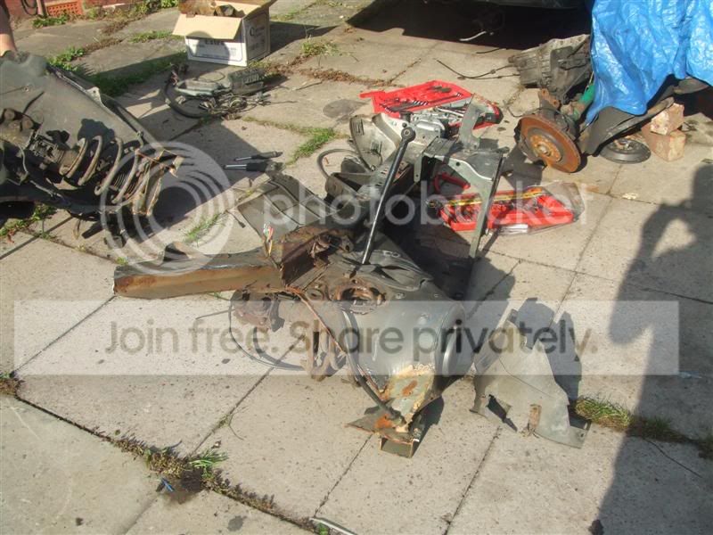

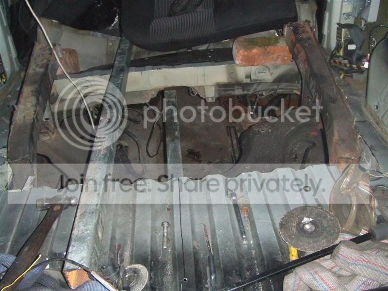

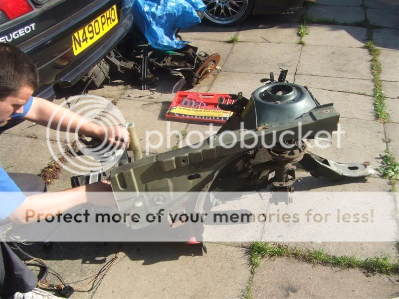

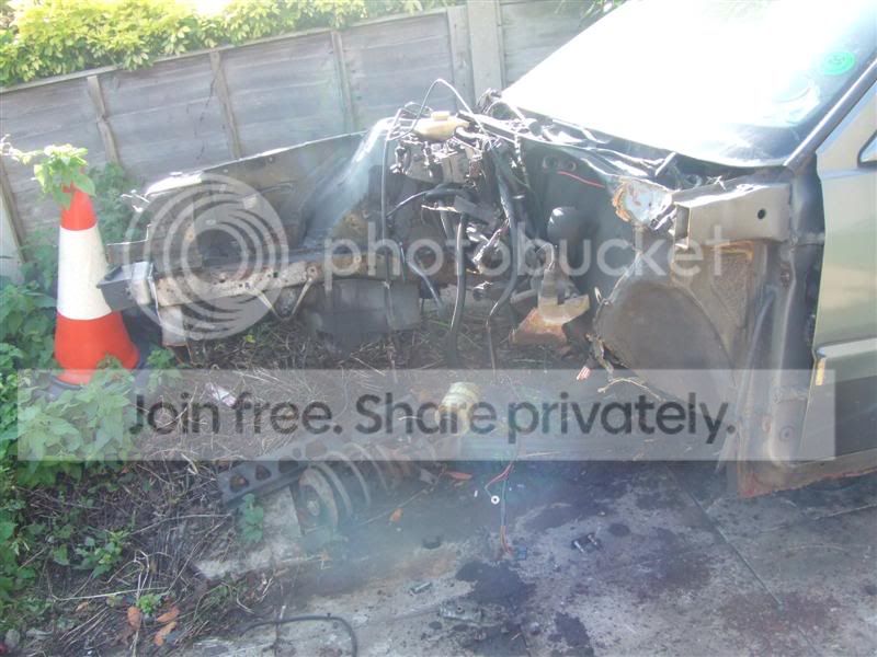

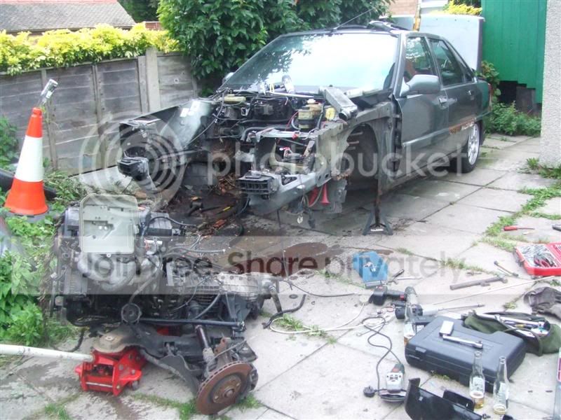

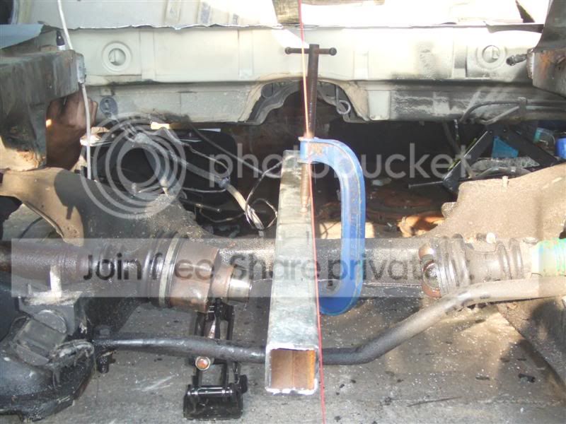

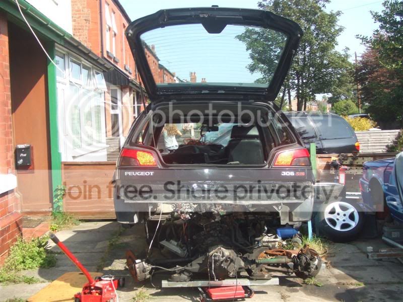

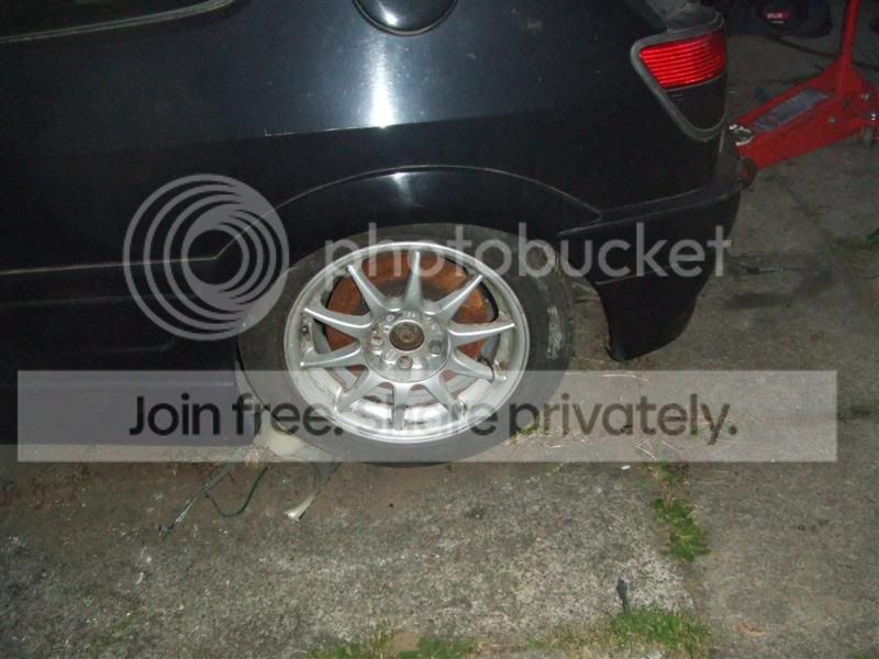

Update time......
Spent sometime on it again with Nutter this weekend. We've had the engine, box & subframe in & out of it more times than I'd like to remember - getting it all lined up & centred - we believe we've cracked it anyway - we've left the subframe & chassic rails bolted up to the rear end at the moment - the track of the car is absolutely perfect & it sits proper in the arches. Bear in mind that theres no suspension hence why its on its arse at the mo!!!
I'll let the pictures explain themselves...
More in a few weeks.....
Goes without saying....BIG UP....to Nutter for all his help - I think if it had been left to me it would be in at an angle!!!!
