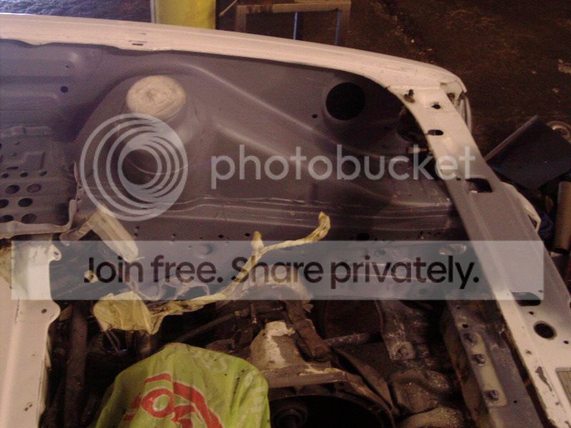

Engine Bay looking more full now (15/02/04)

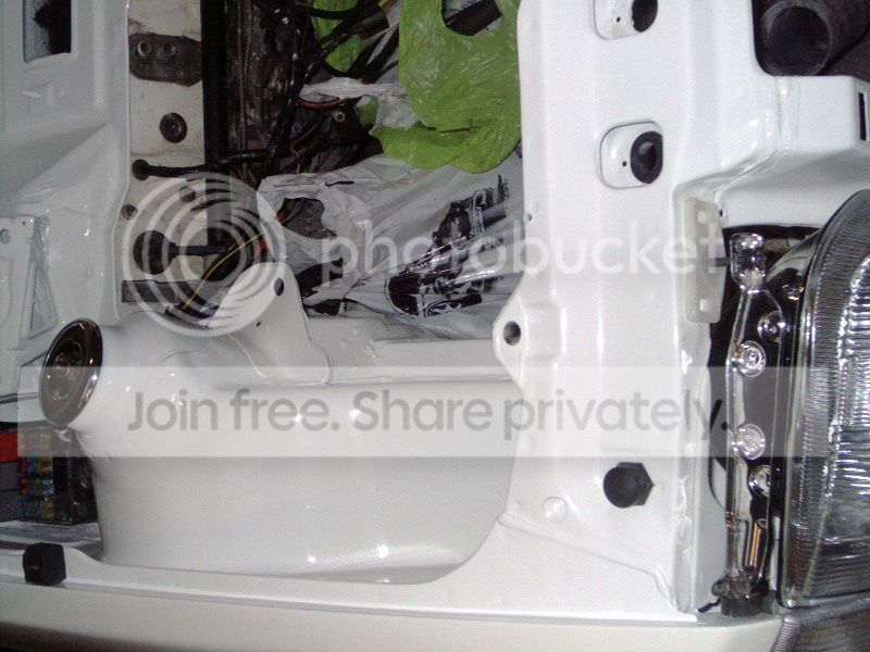

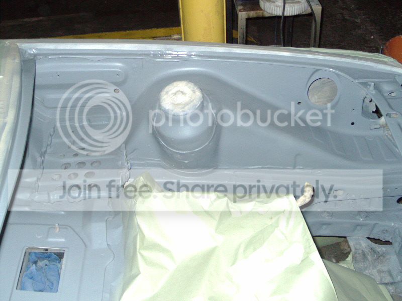

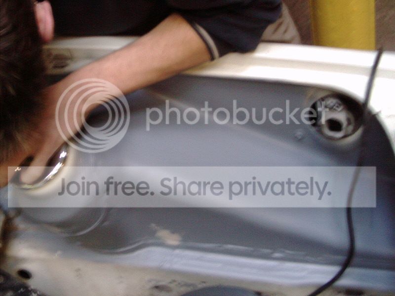

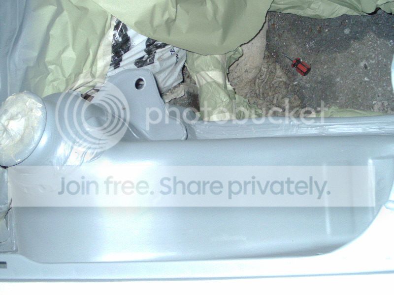

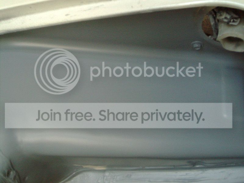

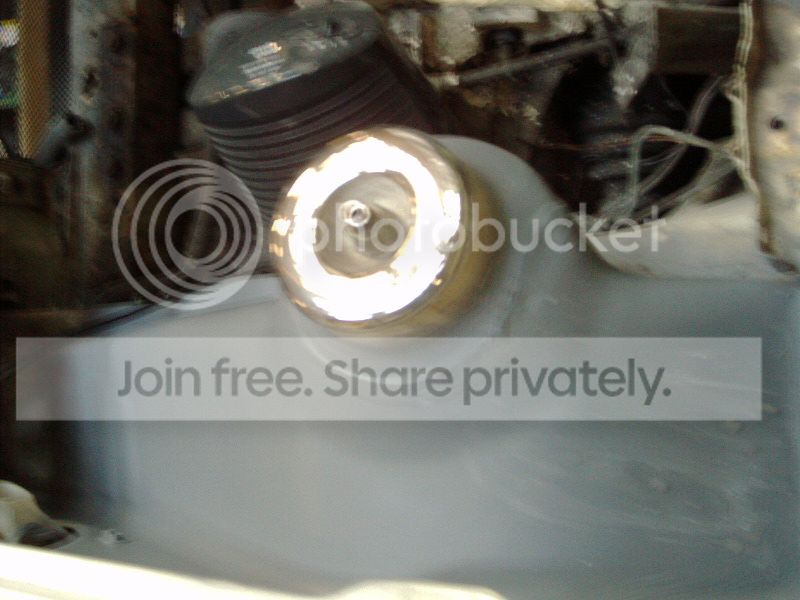

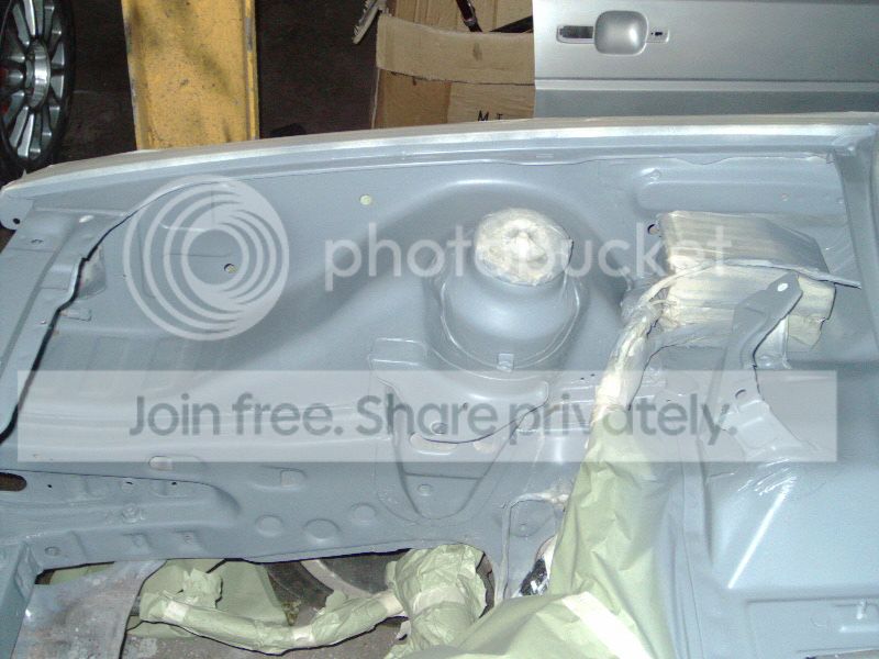

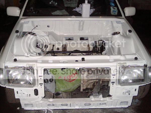

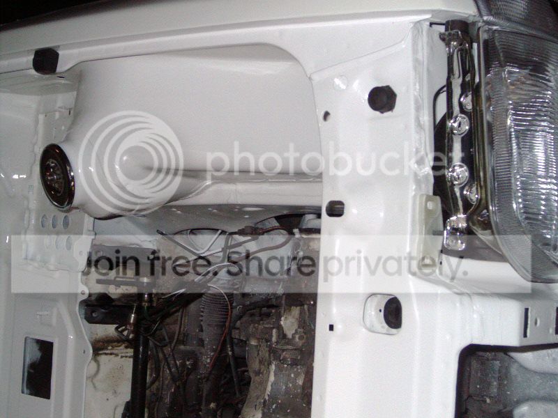

she's now had the first few coats of diamond white applied
Jones doing most important job of the day chief tube holder
Tee's First ever go with a compressor !!
needs rubbing down and laquering now 8)
Join Date: May 2003
Location: oldham / manchester
Posts: 762
hey adam it was done by me and my mate he actualy did the spraying his first go too !! we both spent aboiut a month every sat and sun preping it up
no laquer mixed in we just rubbed the piant back and polished up a treat so left the laquer

Did you use wet'n'dry to rub it down ? what did you use to polish it up ?
I hope to do this to mine when i get my compressor and paint spraying kit
i highly recommend once u painted it. to laquer it. it may be shiny now, wait till u stain it with a little oil or grime, u wont get off in a hurry, with laquer it wipes off alot easier and also protects the paint from the heat and grime
Join Date: May 2003
Posts: 762
was realy expecting to laquer but its come up better than first expected realy so we decided to leave it
looks 10 times better than before so i am happy
Adam it was primered then rubbed back with sand paper (1200) then sprayed up and rubbed back very lightley wiv same (1200) then we used G3 and finally polish to get the shine back up and it looks spot on for our first go

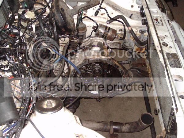

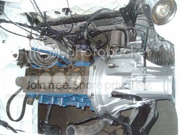

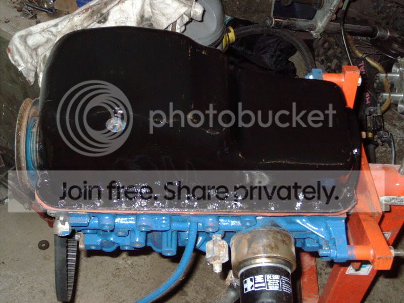

loom is half in now but need a new clutch before bottom end goes back in :S

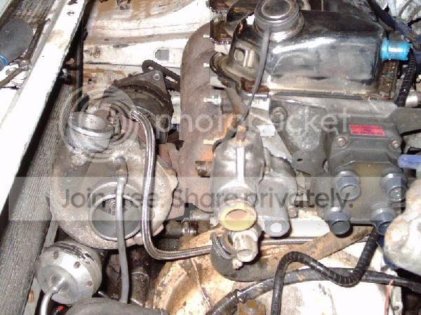

fitted cylinder head and bolted turbo up tonight
PS rocker cover aint staying its just to keep head clean as car is taking a beating in unit

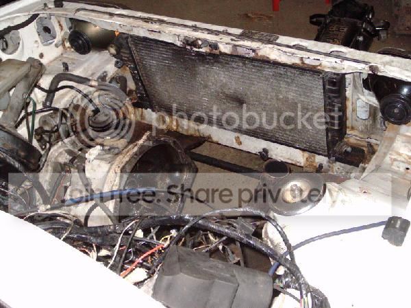

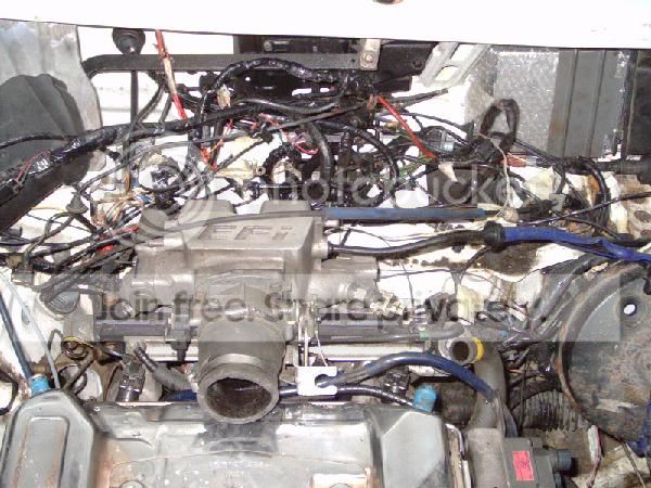

been up today doinga few more bits
new shinny chrome inlet
bit of art attack
brandnew rad and 4x4 intercooler.
bumper on but not bolted up
engine bay getting a bit fuller now
just need a good clean up now lol
bit of art attack
mate looks well nice but i agree with BODGE.....WHY have you left a rusty panel in there? please tell me there was a good reason!!lol!
other than that looks great and ive sat here for the past hour waiting for the pictures to load!!!
nice one and good luck with the rest of the work...wana go crack on with mine now, but have to wait!
