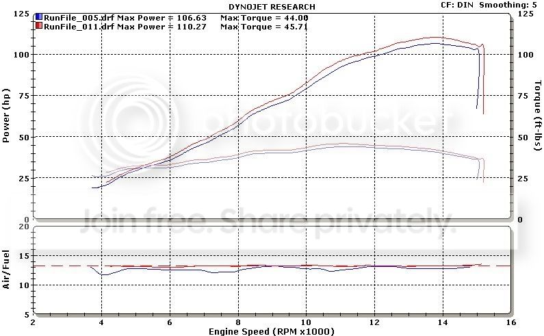

Anyone like to hazard a guess at the power figure?
ZX6R J1 with Dynojet Stage 1, Viper race can and K&N...

Close Joe, 114bhp @ the fly
Not bad considering they are 100ish standard
He's given me some things to think about over the winter, namely a full system and some different jets as it was running a bit rich. I've also got an ignition prob at 2.5k and up at 13k which I've got to track down too
I'll scan the graph in and post it up in a sec

cheers mate, the bloke doing the run was impressed with it, he said I could prob get 120bhp if I put some different jets in the carbs and a full system on there, gives me something to save up for over the winter
here's the graph, you can see the ignition prob right up the top...
top speed was 160mph too

so my Ninja hasn't done bad then, let's just hope I can get rid of those blips up the top...
