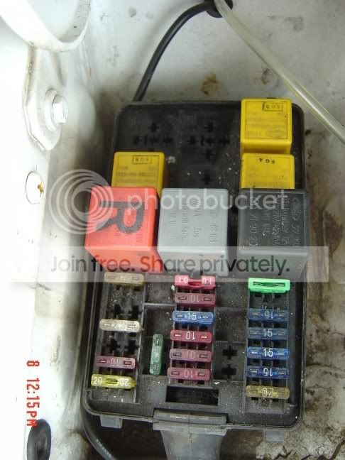

Ive just went and checked and it looks like i dont have this fuse!!!
Its meant to go in the fuse box atr the top of the pic, 1 position in from the left. . . where will i get one?

does the fuse bit have the metal contacts for one?

Not sure will need to look into it further

S1's dont have that fuse
