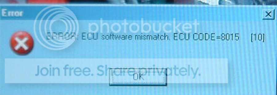

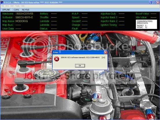

looks like i'm out of luck and the 'IF software version...' bit applies to me. not bothered but you said you wanted to know Simon
brand new laptop
running windows XP
usb to serial converter
which set itself as com2 (saw it in device manager)
i got a bargraph progressing from left to right then about quarter way it came up with

PhilM, Will do later.
the original, thanks for trying it, your ecu is probally well over due
for a software upgrade but at least it proves the new windows version
can use the serial port via usb on windows xp as it had to communicate
to get the information.

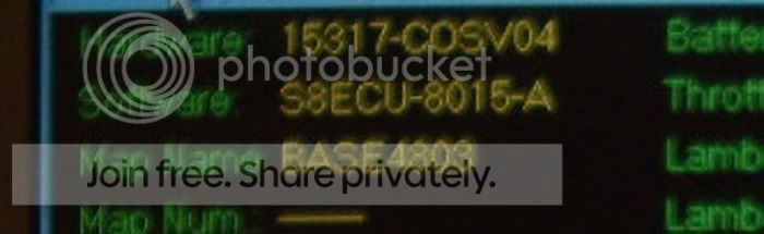

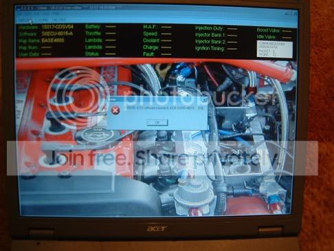

tried it with foreigneRS laptop and his S8 today
he is
hardware version cosv05
software 8015-E
get the same error though
so what are the latest versions Simon?
cheers

The latest original PC software version is 8019.
The windows program I posted here, needs 8017 or higher to work.
I will email you the 8019 update as you are getting your car mapped soon.

Latest
thanks to Simon for the upgrade
loaded it successfully
now have
hardware COSV05
Software 8019-C
The S8 WIN does what it says on the tin
