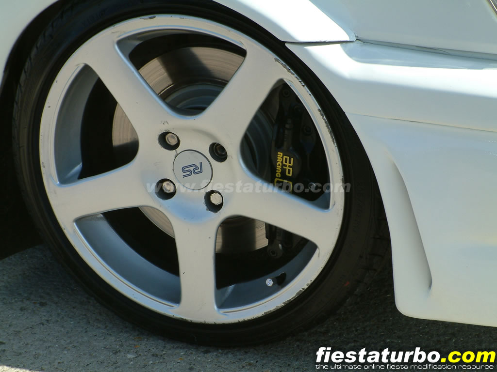

ive got focus rs 324 mm disks on my dax rush which has rsturbo front hubs using the original calipers and works great.
if you want full spec and mod details to fit them pm me. (needs a bit of caliper machining and a 1mm spacer) they fit under my 16inch wheels with about 6mm clearance between the caliper and wheel.

they be 17's tho?
i had them to go behind my 18" kahn rsr's but never fitted them as i sold the car. wish i had fitted them as it would have finished the car off.
