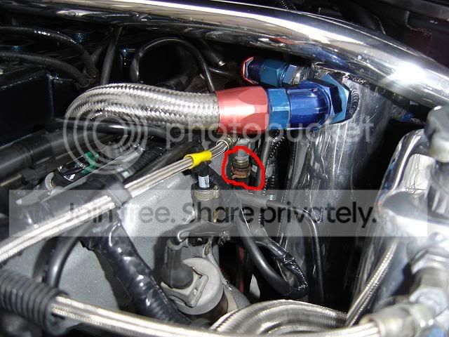

Is one end of the crank sensor the brown bit I have circled in this pic?

No mate thats a vac hose into intle manifold, I recognise that pic
Old Sep 12, 2005 | 07:48 PM
Damo V's Avatar
Damo V
Posts: 9,226
From: SE
is that the area something has been rubbing?? as the crank sensor aint there, just the ACT sensor Or Throttle Position Sensor Or Idle Speed Control Valve

Hi Damo,
Thanks for that, I forgot to mention in the post it was your pic . Can you see the crank position sensor in the pic I have posted or is it nowhere near that area?

i shall find a pioc for you maste

Not that this pic matters, but look at the difference between the two in a couple of months lol, you can JUST about see the plug on the side of the inlet for the ACT sensor though
Right see this pic, see the BIG pulley at the bottom, thats the crank, see the white thing with the white wire going up behind the dizzy, thats the Crank Postion Sensor, when you fit the new one it has to be "gapped" the correct distance from the pulley mate
