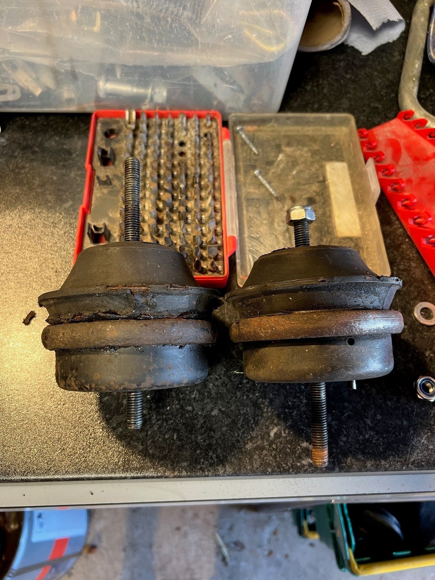

Anyone know what engine mounts are on a standard 3 door Cossie?

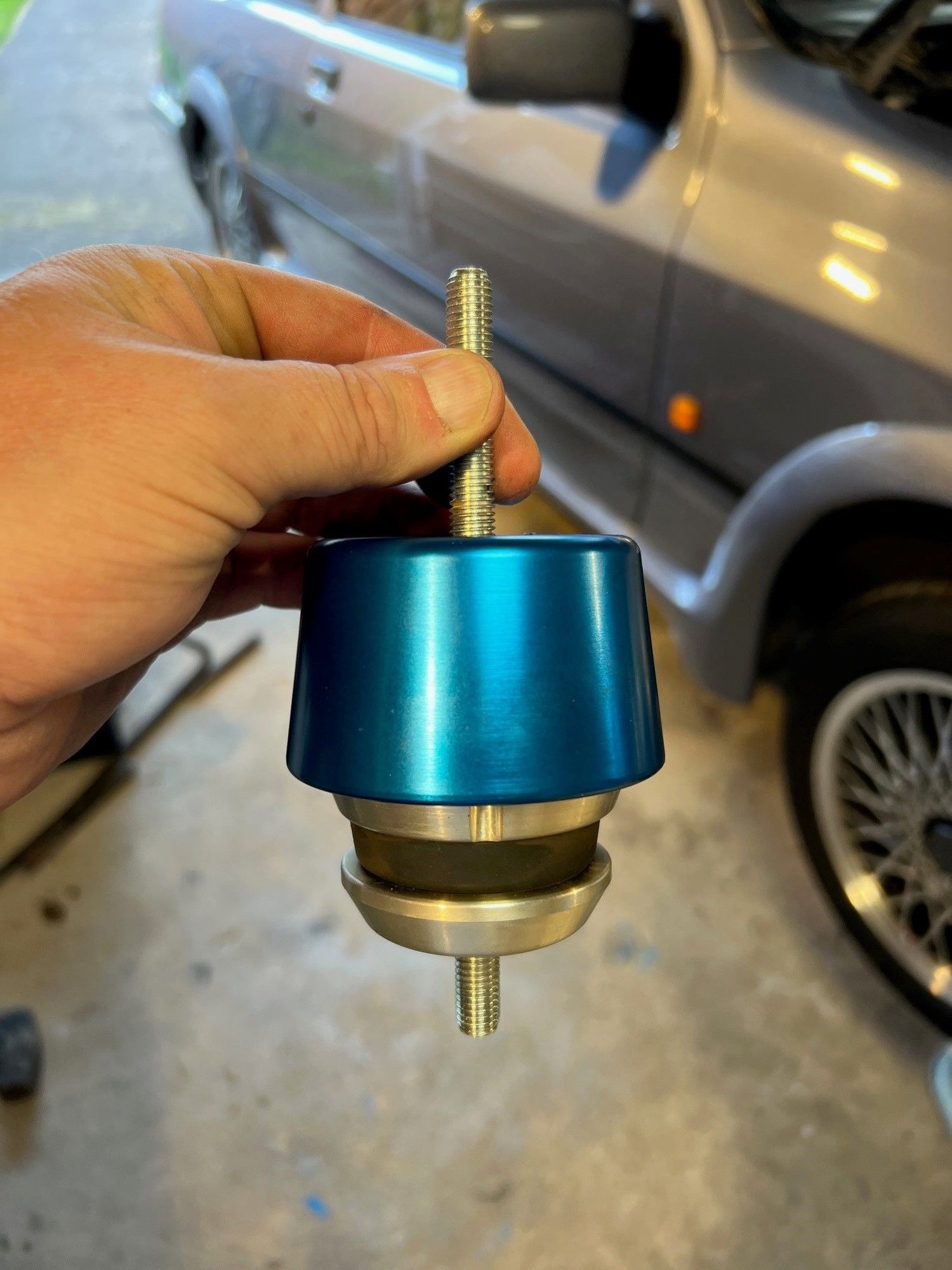

Just removed my old ones to fit a set of Collins ones but they seem to be quite harsh on tickover and low revs .
I's assuming I've not made an arse of fitting them tbh as they look straightforward!

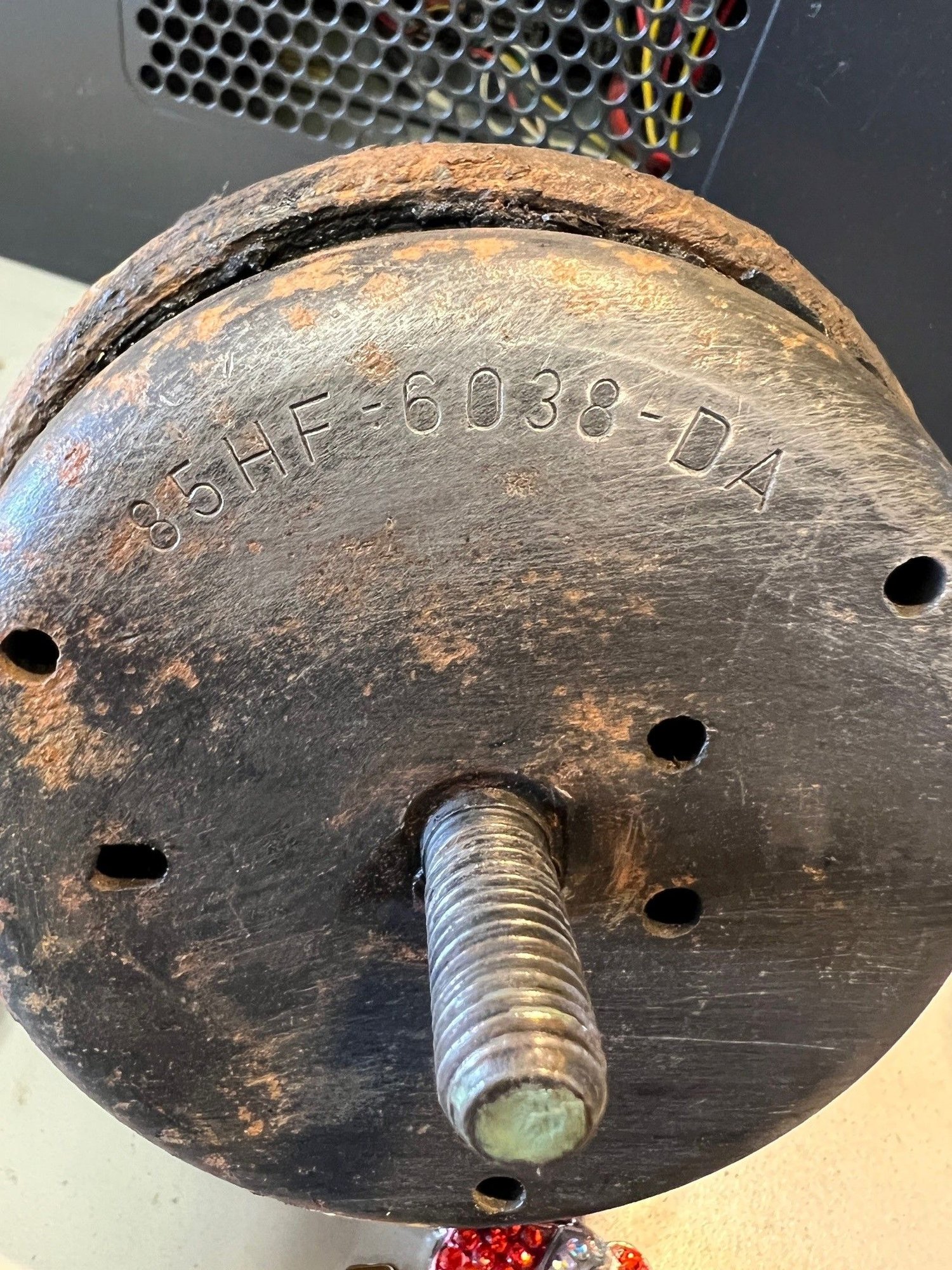

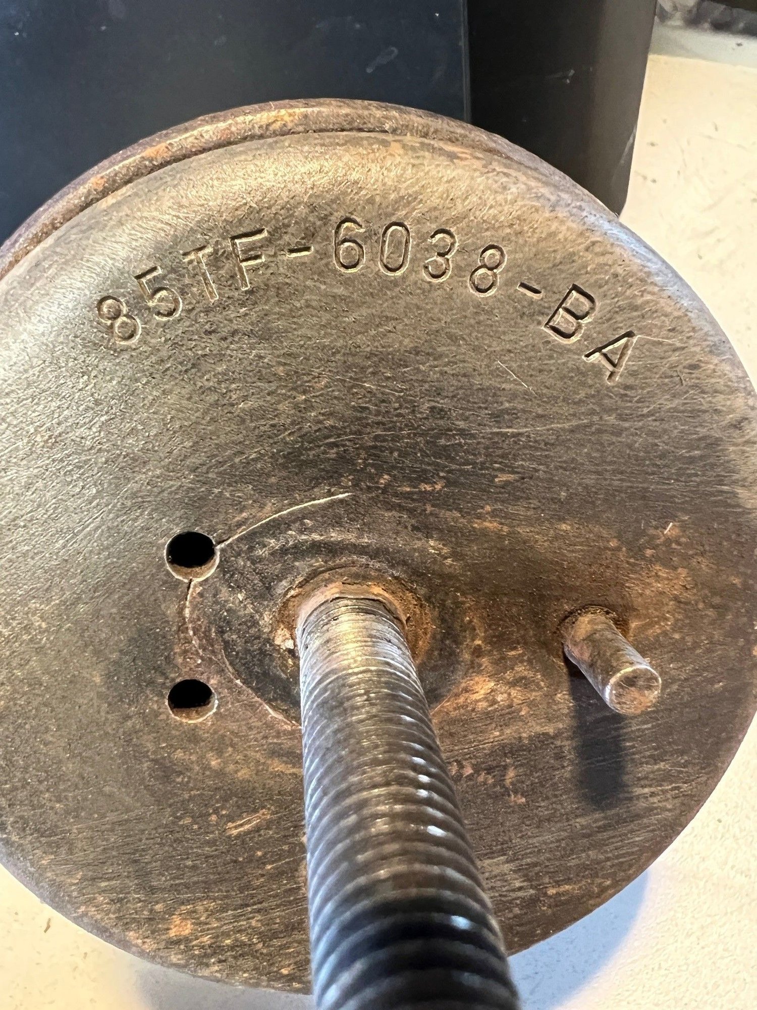

Looking at the old ones, they look different - the numbers are 85HF-6038-DA and 85TF-6038-BA
So which one goes on which side?

Note to one’s self when you remove anything label it so you know where it goes should you need to put it back in its original place
did the Collins ones look the same? If they differed there is a chance they would have been sided, fit specifically to sides.
as for the harshness you’ll find a lot of the replacement/upgraded stuff is made out of different material and cause the car to feel different. I fitted a roll restrictor to my focus rs and it vibrated like a bitch when I first drove the car after it was fitted, so much so I thought I wouldn’t be able to live with it and thought about taking it off. It has settled down though but it’s still noticeable especially when the air con pump is running

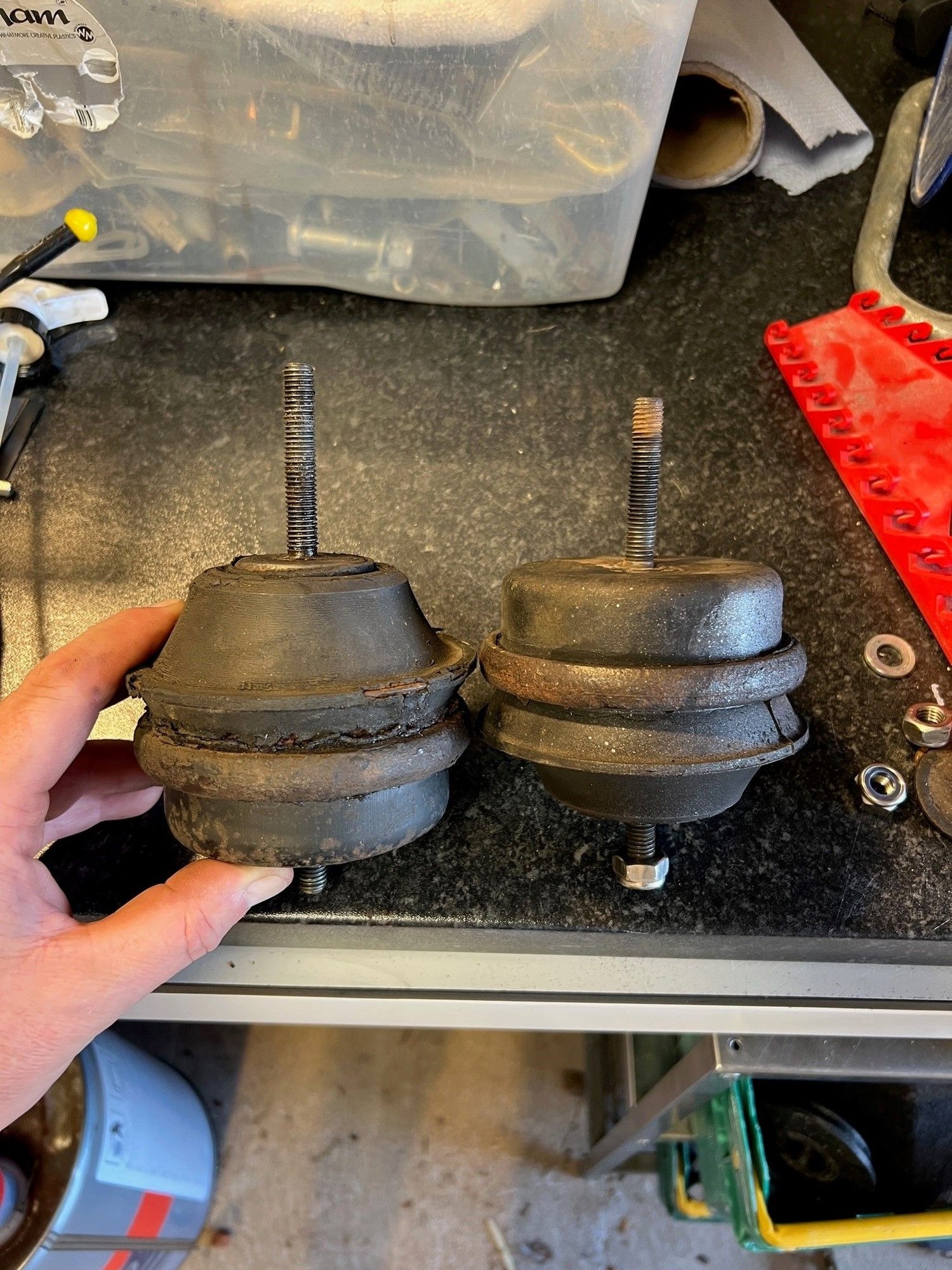

I did mark them but after looking around, I think one of my old mountings might be the wrong one anyway
Found this listing on Ebay - both mountings the same part number in the advert , mine are 2 different part numbers. Been like that for years
https://www.ebay.co.uk/itm/155747195...mis&media=COPY
On mine, the longer threaded rod is reversed on the other mounting.

Someone probably put a like replacement in for one of your originals that’s why they differ in appearance and part number
if the upgraded ones were the same leave them fitted and see if vibration settles down a bit

If I remember rightly left and right are different engine mounts as the locating pin is in a different place, on stock mounts that is.
I have Collins engine mounts in mine, they are stil harsh some vibration but they are miles better than the vibratechnics that I took off, I dont know how rod lived with it it was horrendous knock ya fillings out bad 😂🤣😂🤣
​​​​​​Collins still firm but it's bearable imo

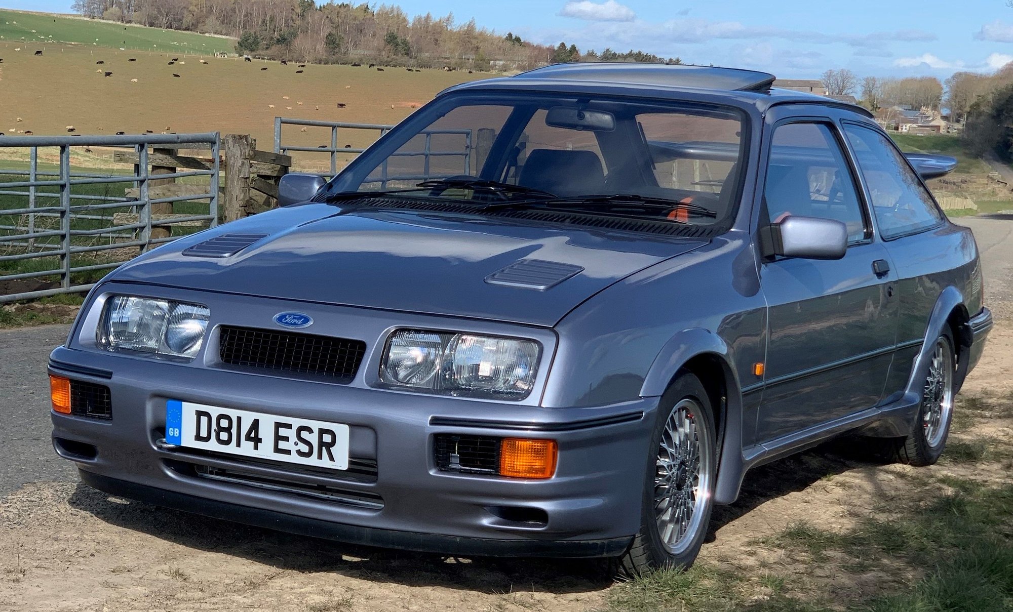

Pic of the car in case anyone is interested sometimes use it for the school run, my wee girl loves it

Car looks lovely mate I had a moonstone years ago 🥰🥰
