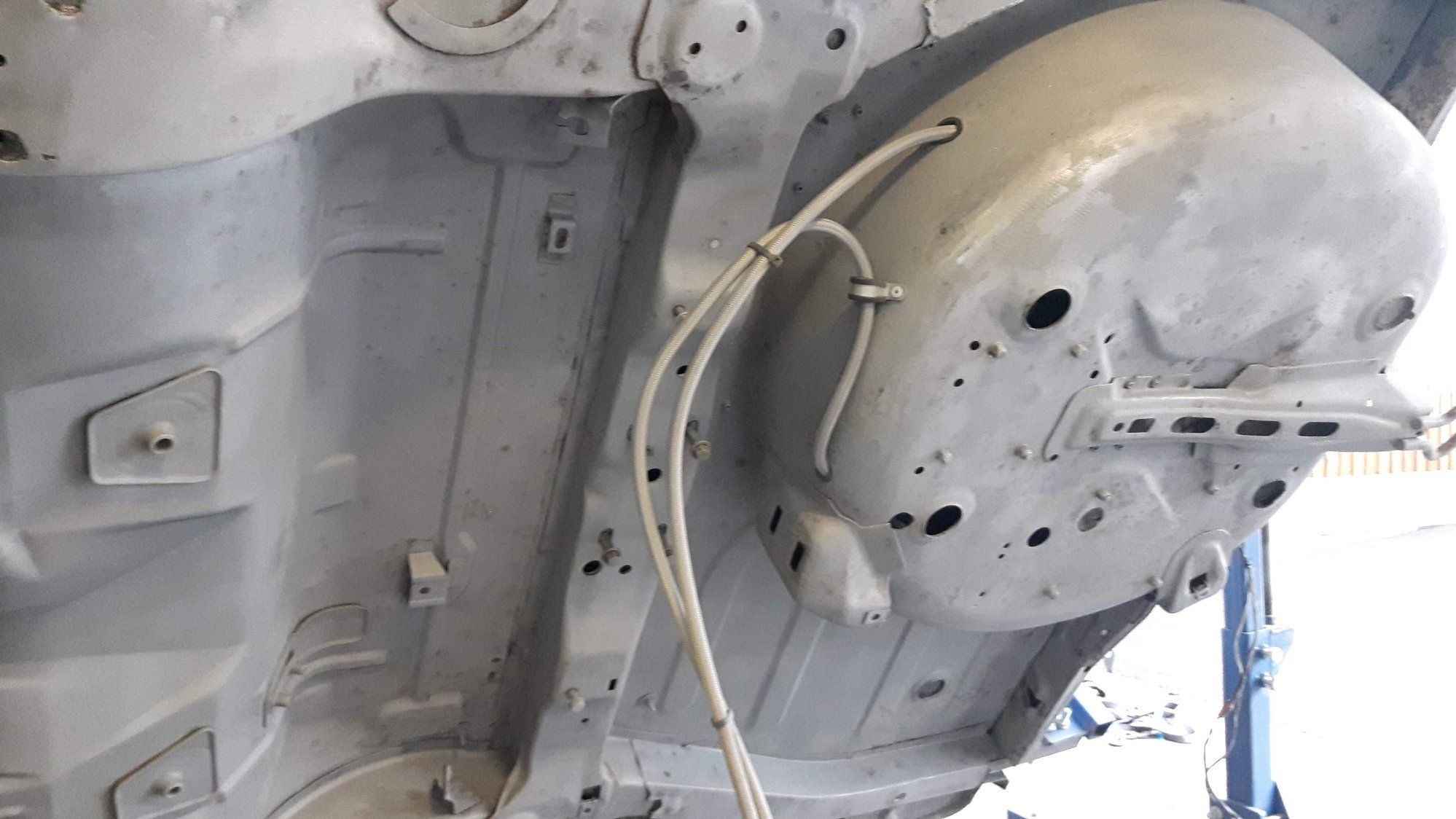

Hi I’ve had the underside blasted today and will be welding for the next 3 weeks. Will it be ok to paint after I’ve welded or do I need to put a protection on before? The car is inside my garage with a dehumidifier many thanks

Use something like gravitex stone guard first which is over paintable then you have good protection underneath the paint.

I mean as a base coat for example 2k epoxy primer

you can always use weld through primer, the project binky boys seem to love it and i haven't seen any rust on that yet

Look up buzzweld war mate... right stuff .

I would give it a quick coat of epoxy and make good any burns to it you get with welding.
https://www.rust.co.uk/product/cat/c...body-primer-27
