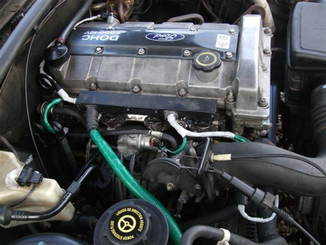

Did you get the 2.3 or 2.0 DOHC 16v Ford Galaxy / Scorpio engine out there ?
Based on the same block as the 2 litre DOHC 8 valve motor you already have, everything should pretty much bolt on if you block of the oil feed to balancer shafts in the 2.3 sump
