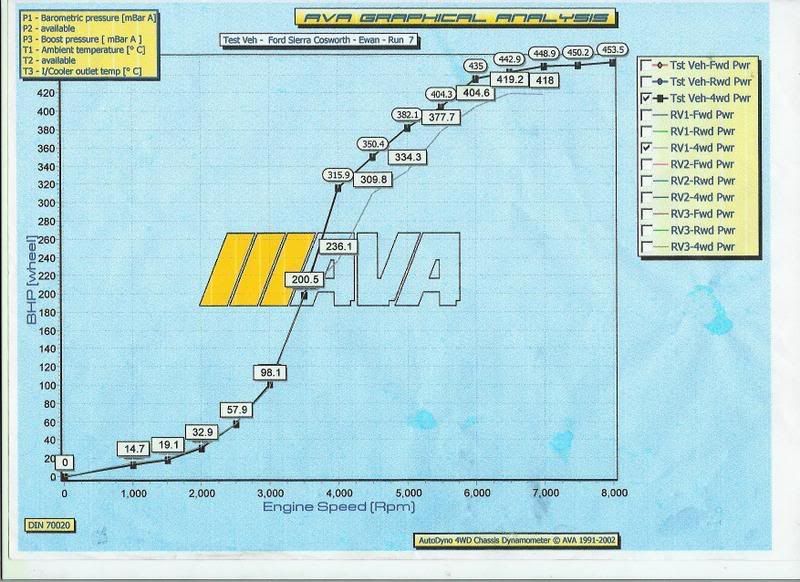

This is what happened to Euans car when AVA got rid of a 3" Magnex for their own system, 4" down pipe and twin 3" system IIRC.
yeah thats what i remembered i just couldnt be arsed to go find the proof lol
