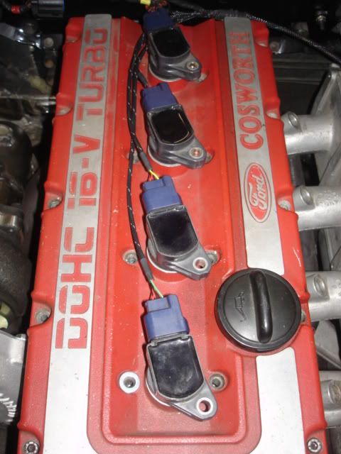

here you go , a pic of the yaris cop arrangement
TOYOTA Yaris DENSO 90919 - 02244
Been looking at these too, you can get 4 for the price of a tuners 1

I'm trying these on my 500..

Originally Posted by M K
are they the toyota cop Martin?
No, They're off a Honda Civic Type R.
I have these also on mine.

yes they are inductive, and they will take a std plug.
the hardest thing i found to get when i decided to use them was the multiplugs, could get the pins for the plugs, just couldnt get the actual plastic sockets. got sorted in the end though.
