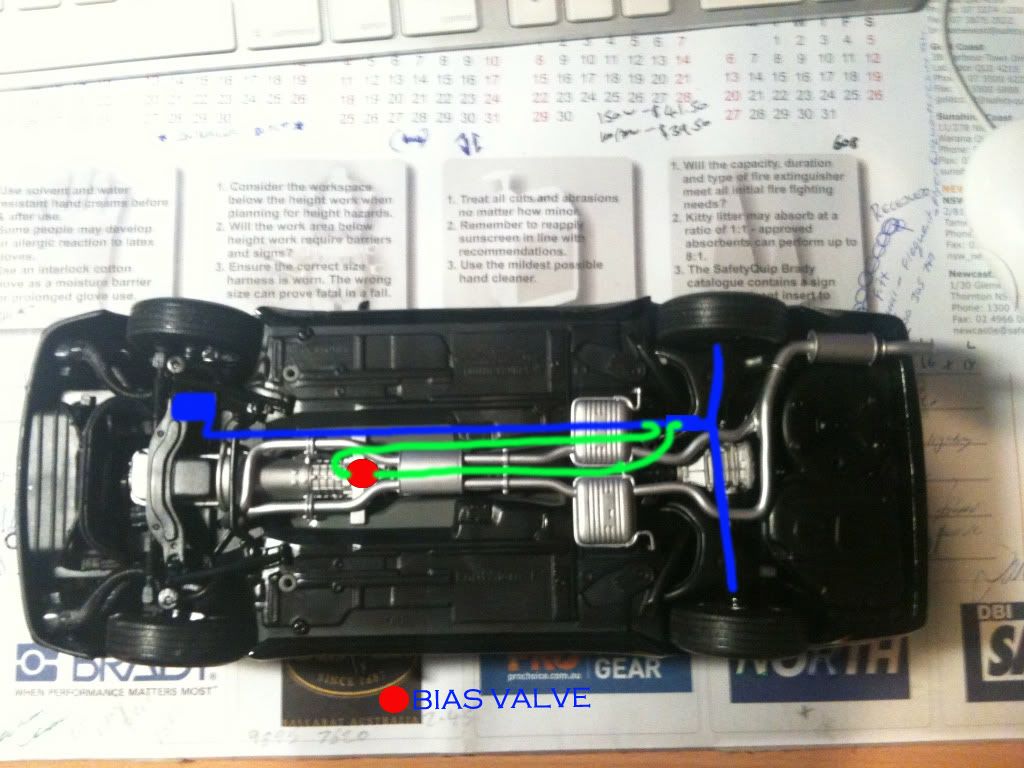

How do people get the brake lines etc to the valve?
Is just a simple do some mesauring, remove the line and fit diffrent ends or is there a easir way ?
Im putting the valve in the arm rest area

I fitted all braided lines on my car so was easy to fit, but yeah re route the line to he bias job done, though you will have2 rears? So not sure how you will do it
and you have abs

Well id still use a T peice in the rear.. Iv done a diagram of the setup i have in mind il post it up

the blue lines are the orignial lines and the green ones would be braided lines

your diagram above is exactly how I was told to fit my bias valve

So pretty much keep the standard lines in place and add the braided hoses.. Did you fit yours jon?
