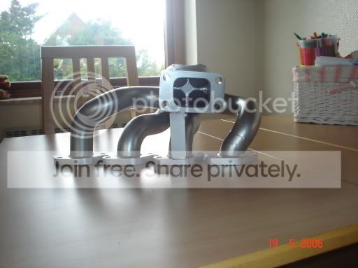

click my sig, there are some pics of my 200sx manifold somewhere lol, they are not great pics tho
i basically cut off the 200sx flange, and modifed a zetec flange to fit, then had it welded on.
they are for a top mount turbo tho, and if its to go a fwd car, then you will either have to cut a bloody great hole in the bonnet, or might get away with turning it upide down

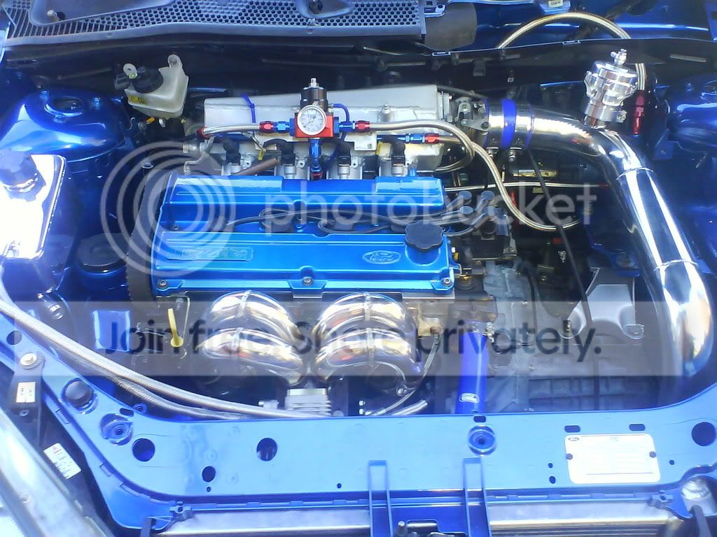

heres a pic of the one i made for mine and it works very well.
nice what manifold was that to start with? escort?

Likes: 14
From: merseyside
200sx

i think it works well on my car but im sure some on here will disagree,
its not holding my car back as yet, every time we add more boost it makes more power heres a better pic of it.
ps it started life as a rover inlet.

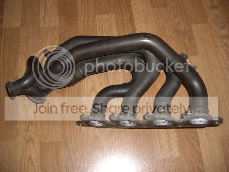

hi mate there are lots of options of different turbo manifolds for zetecs and lots of prices as well , lets start with the cheapest first
first is cvh erst but you will have to drill and tap the head as they have different bolt patterns £40 for manifold and £50 for drilling and tapping
focus rs manifold but you would need to use a gt28 turbo , £100
then its the obx pretty cheap but have heard that they crack and on more than one
i think they are about £250 on ebay
then theres the hansen turbo manifold that jamsport uses , very well made and built
again i think about £650
then theres area six manifolds which place the turbo over the gearbox , there are 3 stages of build .
cone design good for 500+bhp £550
the new merge collector will out flow the cone design (600+bhp) £650
with merge collector fitted with 2 v band clamps , 1 at the end of the merge collector and 1 at the turbo flange allowing the turbo to be fine adjusted to every cars engine bay (600+bhp) £850
all area six style manifolds can come with external wastegate options
then theres primary designs manifold , very similar to the obx manifold but alot more costly at £1000
or you may be able to get a wrc manifold which cost anything between £700 to £1500 if you can find one and would most probably need cutting and fabricating to fit your engine bay
hope this helps
cheers paul

cheers mate very usefull indeed what manifold r u running the one are the car looks sweet is that the obx one? aso i only plan on max 300 bhp so what manifold would u say would be best for that
