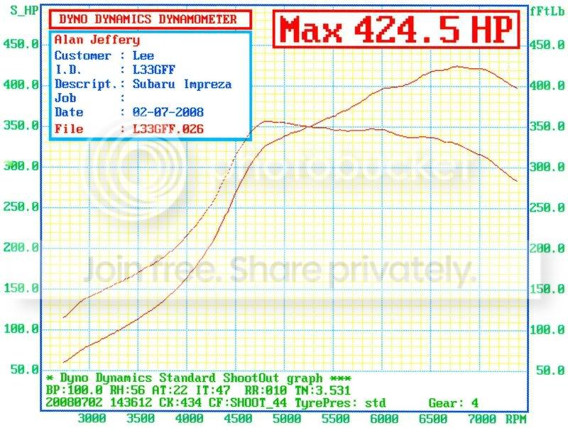

Was trying to explain something to someone, and they thought I was making it up about IT giving mis readings.
Here is the graph we were discussing:
Well i never.... our old friend Alan

i dont use the sensor in the airfilter as they just end up with figures like the graph above
when mapping with the inlet temp probe near filter after a few runs on dyno it can increase so figures become inflated

It's in the wrong gear too.

On the graph in question, the person informs me the intake temp probe was put INSIDE his boost pipework.
I personally think he MUST have that incorrect, as I just dont see logistically how you would get it in there, but on the other hand it certainly looks like it was!

And because if you build two identical engines and roller one on a hot day and one on a cold day they would get totally different figures.
How the hell is that useful for developing an engine?
Any engine from december would seem massively better than any engine you built in july!
Old Nov 26, 2008 | 08:59 AM
Chip's Avatar
Chip
*** Sierra RS Custard ***
Joined: Dec 2006
Posts: 47,250
Likes: 22
Originally Posted by dojj
so where should this temprature measurement be taken from then?
Its supposed to be a measure of the temperature of air going into the air filter.
Where you choose to get a reading from to represent that is a matter of some debate, but not a lot, essentially it needs to be somewhere between the air filter and the dyno wall, where you think it best respresents the actual temperature of air that will go into the air filter, often putting it to close will result in it picking up radiant energy from hot engine components that will make the sensor hot but wont heat up the air going in to the same extent.
Im with Gary in that two far away is better than too close if you have to be either.
one side of me thinks that putting it as close to the actual inlet manifold as possible because then you have the actual temprature of the air that is being used by the engine, after it's gone through whatever induction pipework form the air filter, as possible to see what sort of fueling you would need
the other side of me thinks that it should be placed at the air filter side so that you know the temp of the air coming in, and that the sensor may misread due to it being cooled/heated by the air rushing past in the inlet manifold and generally being hotter than it should due to the heat coming from the engine
is there a difiniative right or wrong answer to this or does it depend on the operator in question?
On a turbo car, putting it AFTER the turbo is always going to make it think the air coming into the air filter was hotter than it really was as the turbo compresses the air, which heats it up! (pv=nrt)
Old Nov 26, 2008 | 09:49 AM
Martin-Hadland's Avatar
Martin-Hadland
1st to 200 without NOS
Posts: 12,304
Likes: 121
From: Birmingham
that's nonsense. it should be in the intake so that it measures intake air temperature. unless it has a huge thermal mass, the sensor will read the actual temperature of the air being ingested by the engine in that position (wether it has been heated above the AT or not).
Exactly what I do, take it from next to the air filter intake or roght next to it.
Old Nov 26, 2008 | 09:57 AM
Chip's Avatar
Chip
Joined: Dec 2006
Posts: 47,250
Likes: 22
Martin do you have some graphs to show the IT you get doing it this way mate?
1 at the beginning of a long mapping session and one at the end would be perfect
