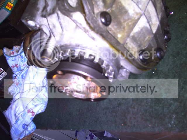

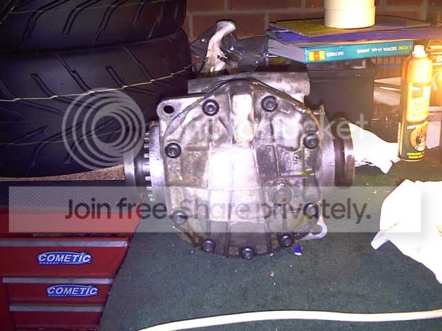

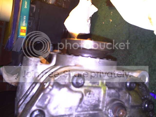

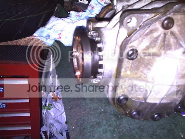

i have been trying to rebuild the plated rear diff today,got it all back together but one side is further out than the other,it works and seems to operate ok,but is this ok,

hi lloyd
how have you held the input shafts in ? and why are you using a 7" version ? you will break it again

hi marco,input shafts are bolted in. the 7 inch diff and adjustable rear beam where done when the car had the 420 bhp engine with anti lag.so would have been ok at that spec.
