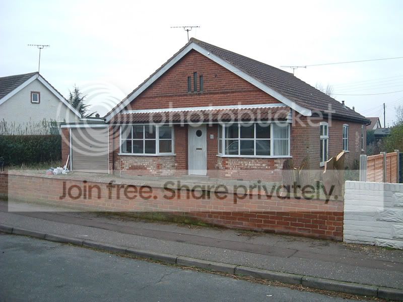

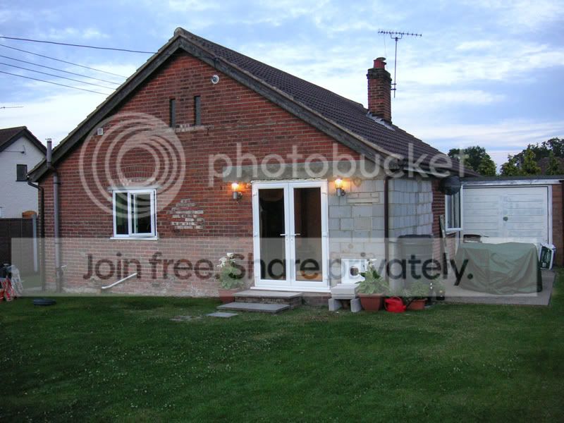

Old Mar 19, 2007 | 07:12 PM
Christian and Beccy's Avatar
Christian and Beccy
#1 in Spelling Club
iTrader: (14)
Posts: 23,329
From: Norfolk
These pics are quite old, particularly the first one, just after we bought it, but you get the idea!!

Old Mar 19, 2007 | 07:50 PM
Shings's Avatar
Shings
Posts: 8,655
From: .
Christian.
Lets get some measurements.
Get a height to eaves and get a length across the back of the building and down 1 side.
I'll work out the square meterage rough;y from those measurements before deductions.
You've got 2 gable ends.
Some tricky little windows.
2 bay windows
Gonna need scaffold to do the gable on the front of the house due to the porch/little roof thing.
Is the garage included in the price???
Jake

I'm guessing that we have been quoted for worst-case scenario all round. As in, if they have to rawlplug and screw ALL the mesh, but I guess they will be trying to nail it etc. However, I bet we don't get a reduction if they do it quicker, they will just knock off a little earlier.
I can't measure at the moment, but thinking of it logically, the 2 rooms at the front (as in, the ones with the bays) are just over 3 metres wide each, so that must make the front and rear 8 metres long, roughly.
The side that can be seen from the front view, with the 3 windows has the bathroom (4 metres long), Rosie's room, (2.5 metres) long and our bedroom (3 metres long). So, that must make the sides around 9.5-10 metres long.
The garage has a door on the front and rear at the moment. So those walls can hardy count as there is hardy any wall and the side is obviously part of the 10 metre total length of the side of the bungalow.
So, take 2 x 10m and 2 x 8m, which makes 36m, multiplied by the height (2.5m for example), makes 90m. Then the gable ends. Even over-estimating, I am struggling to find much over 100sq metres.
I think some other quotes are needed. It's just tough, because there really aren't that many people that I feel inclined to want them to quote!

I would agree- 100 m2 would probably be about right....
be good to get some accurate measurements though Chris- then you can go to the other contractors and explain what it is you need and get a more sensible quote..

Update. I have measured the bungalow now and to my surprise it looks like it is 140sq metres. Thats pure surface area, not taking anything off for doors/windows etc. So it seems that the guy that quoted wasn't far out with his measurements, but I still think 30 man/days is FAR too long for that job.
Further to the replies above, we are now looking at External Insulation, the type where they screw panels to the exterior, then render over the whole lot. I have seen some houses being done locally and I am interested to know how much it will cost. We need the place insulated anyway and having this done will give a nice regular surface for the render, which must cut down the time it takes.
