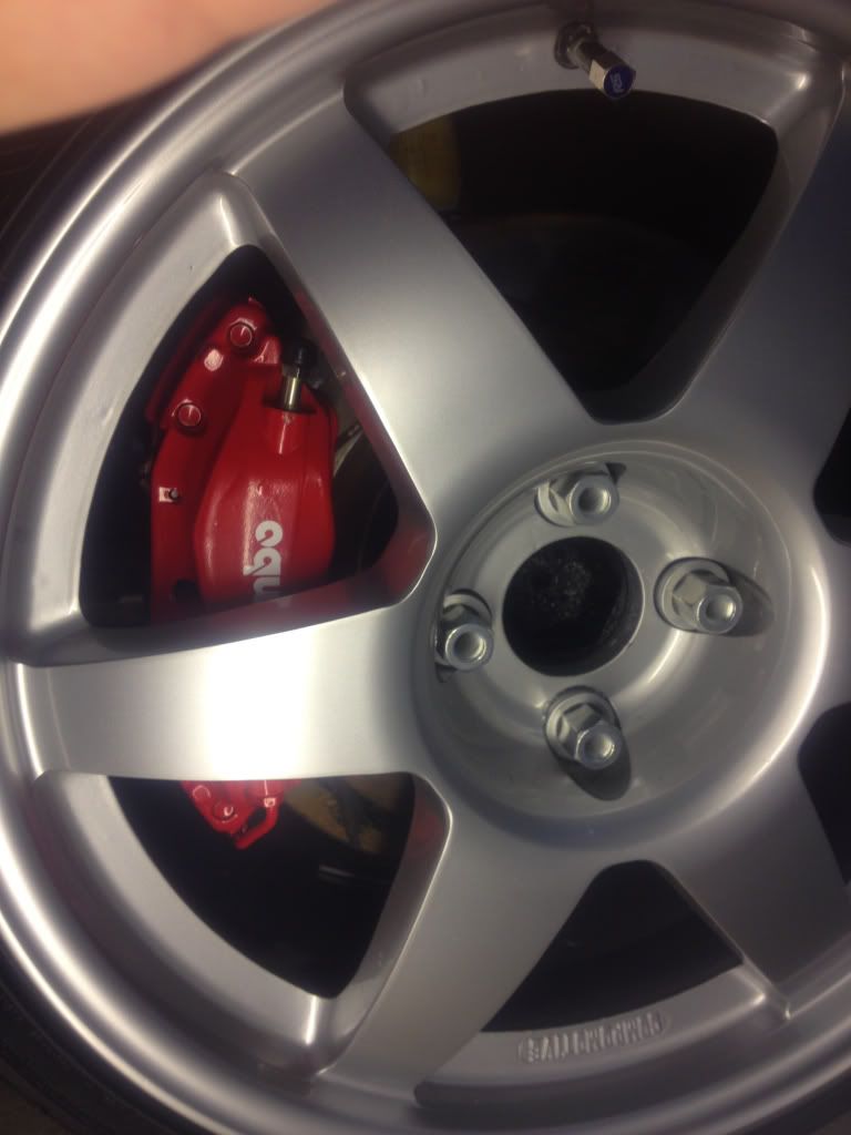

Just done the E38 brembo conversion and it works well and cost me about. 180 so far and just need some spare funds for some new FRS disks and the jobs done
Looks great matey
Is yours a 4x4? (sorry cant remember)
Want to do my 3 Door Cossie and Sapphire Cossy with these

are the focus discs 2002-2005, and do you need to have some brake pipes made up or do the standard ones still fit
