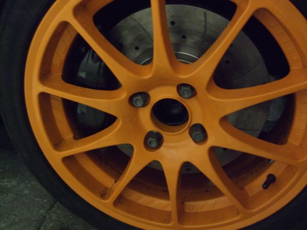

will be fitting mine in the next few days when the discs come can anyone advise on brake pipes dos the cossie ones fit or is it case of getting braided made ?
Old Mar 19, 2013 | 11:16 PM
  #48
Paul500+'s Avatar
Paul500+
Joined: Dec 2011
Posts: 373
From: westyorkshire
in case any one else will be fitting these thay do fit with cossie brake pipes

The problem with the 4x4 is not the brackets for the calipers, it's the disc offset. Both the 300 mm ST170 discs and the 320 mm FRS discs have too much offset which means the disc will hit the steering ball joint.
Perhaps the E38 calipers can be used with a set of 320/330 mm AP/HiSpec/etc. discs that have the correct offset for the 4x4. You only need to check that the disc thickness matches the original thickness of the E38, otherwise the disc might be too thick.

got mine fitted today not drove it yet tho
Old Mar 29, 2013 | 07:07 PM
  #57
Paul500+'s Avatar
Paul500+
Joined: Dec 2011
Posts: 373
From: westyorkshire
can recommend these guys ive add the car out today for a little run the brake set up is very good the spacers that come with the brackets are two wide tho,caliper hits the disc so i add some more made

I have everything here to do the conversion, what needs changed about the spacers?
Old Mar 30, 2013 | 09:57 PM
  #59
Paul500+'s Avatar
Paul500+
Joined: Dec 2011
Posts: 373
From: westyorkshire
need to be thinner or the caliper dosent sit central with the disc, in my case the caliper was catching the disc don't know if any one else as had the same problem ?
Old Apr 1, 2013 | 09:47 AM
  #60
dakar's Avatar
dakar
Joined: Sep 2006
Posts: 2,350
From: york
Yeah had same problem so just used normal washers as spacers
