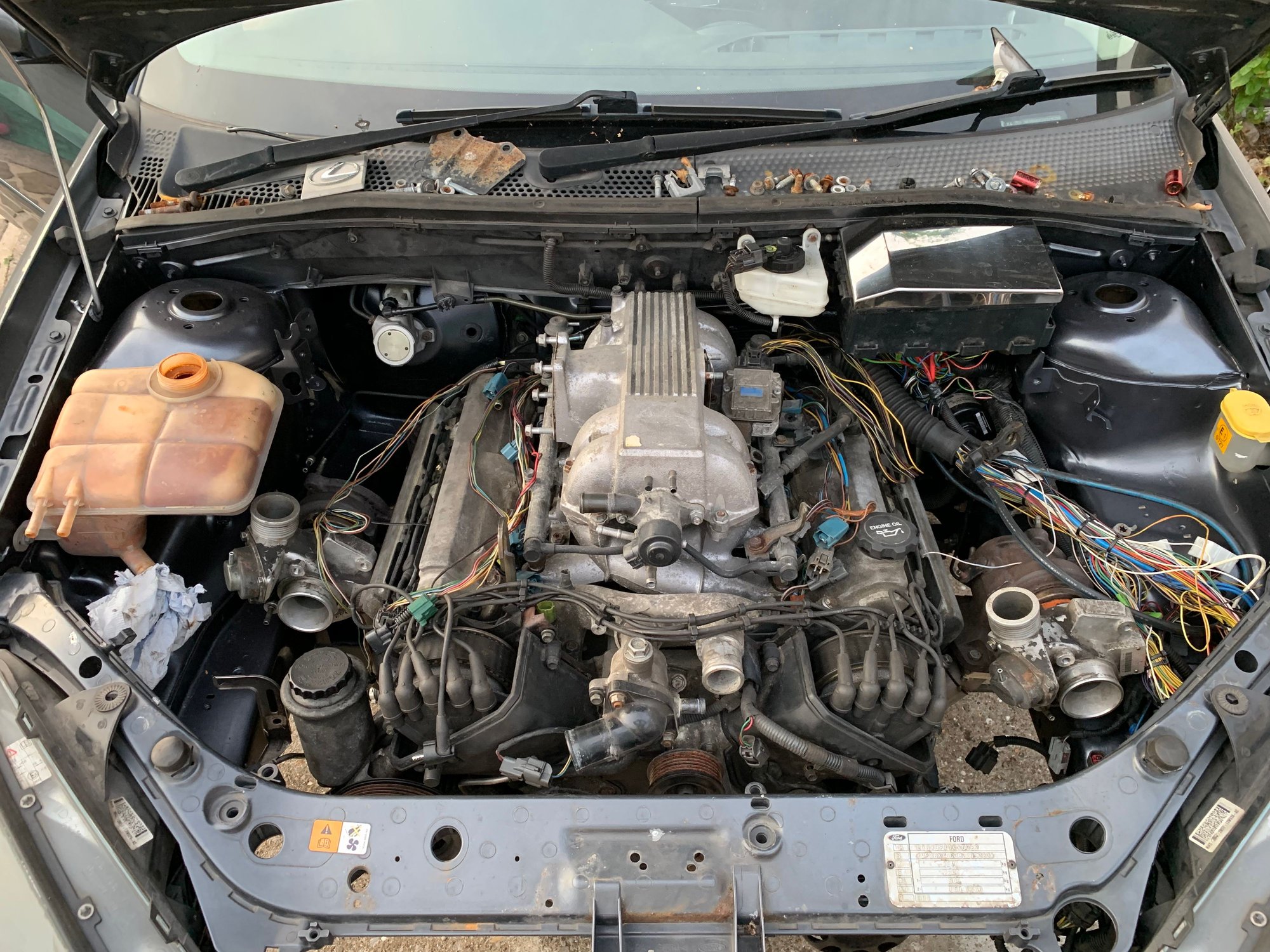

Hi,
the basics - im putting a V8 in my focus ST170 and I want to use the Standard instrument cluster, I understand they're linked with the focus ECU.
My question is, is it standard CAN protocol that communicates between the 2? if not is there another solution?
I'm using the standard Toyota V8 ecu so it can output generic signals (tacho, temperature etc.) but other than tricking the focus ecu in thinking the engine is running I'm at a little bit of a loss.
Anyone got any information I can use? I'm trying to find a pin out for the instrument cluster which would at least help me with what I can connect directly and what I will need to "fudge"
Help me please lol

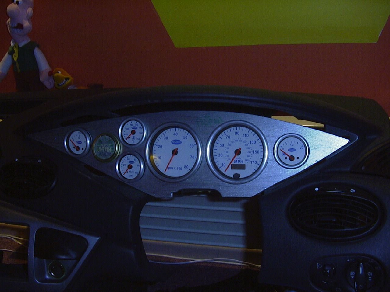

The simplest way would be to adapt Toyota gauges to fit the Focus dash.
You've got enough to do without spending (or maybe wasting) weeks trying to get just the dash working.

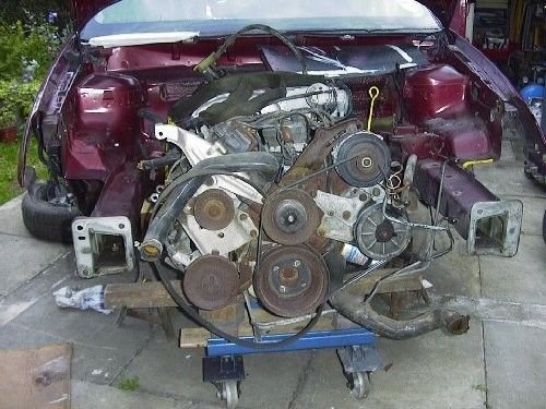

This was the start of mine in 2003.
Ford 5.0 V8 into year 2000 Estate.
Lost interest and got distracted many times and gave up in the end.

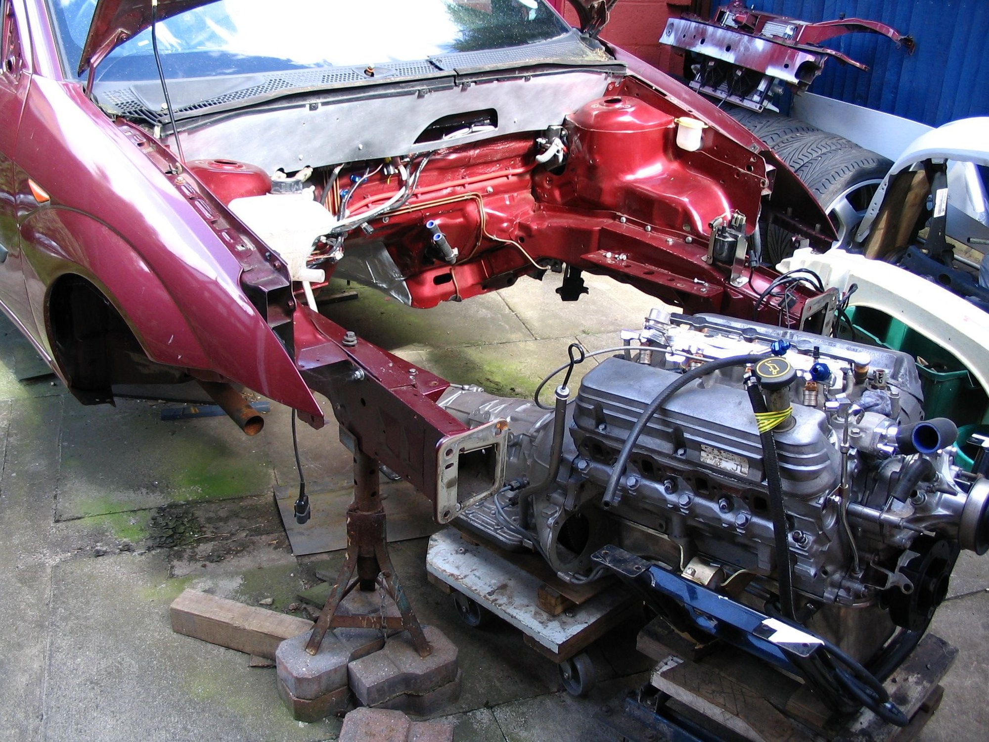

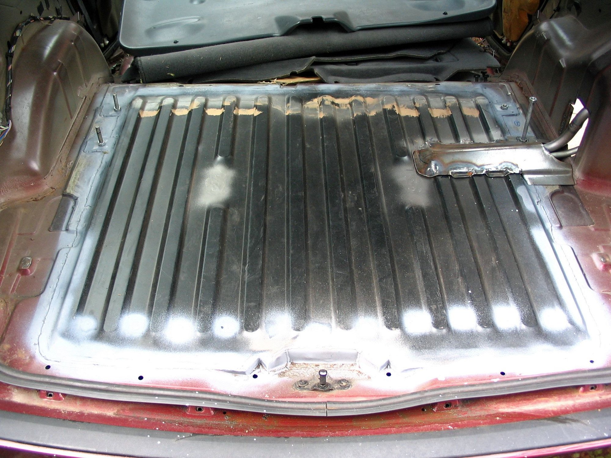

Had the same thought myself especially when trying to fit a rather large autobox in a non existant tunnel.
Probably got 80% done but had quite a few a lot of things I wanted to redo.

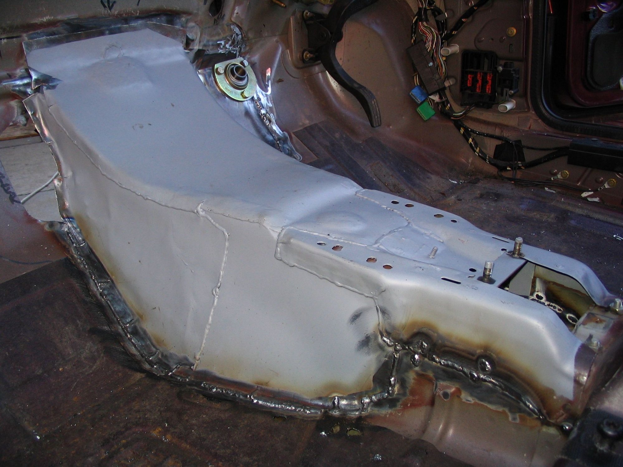

Mostly complete engine bay;
What went in it;
Transmission tunnel

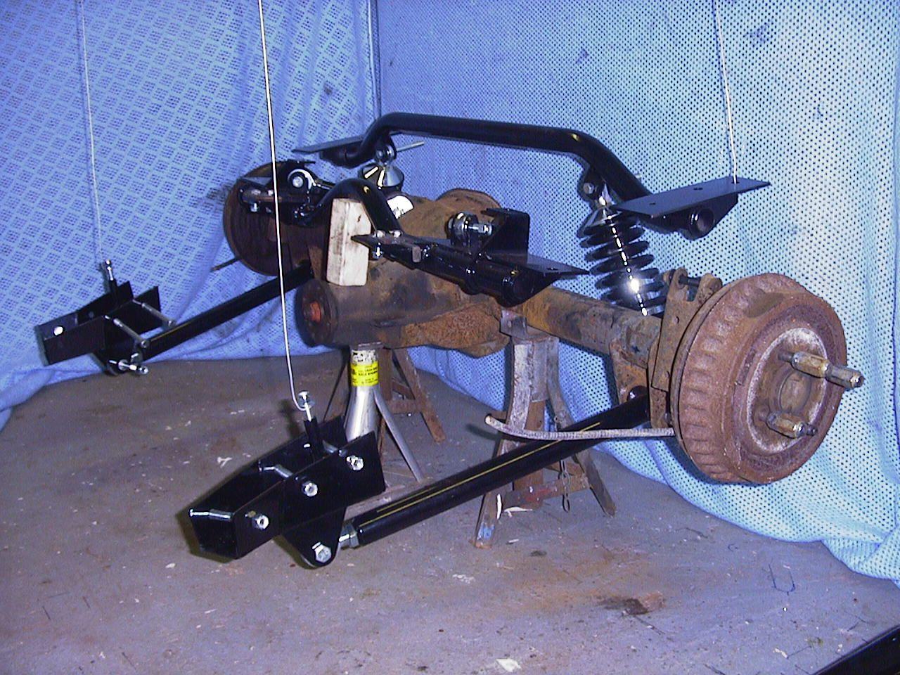

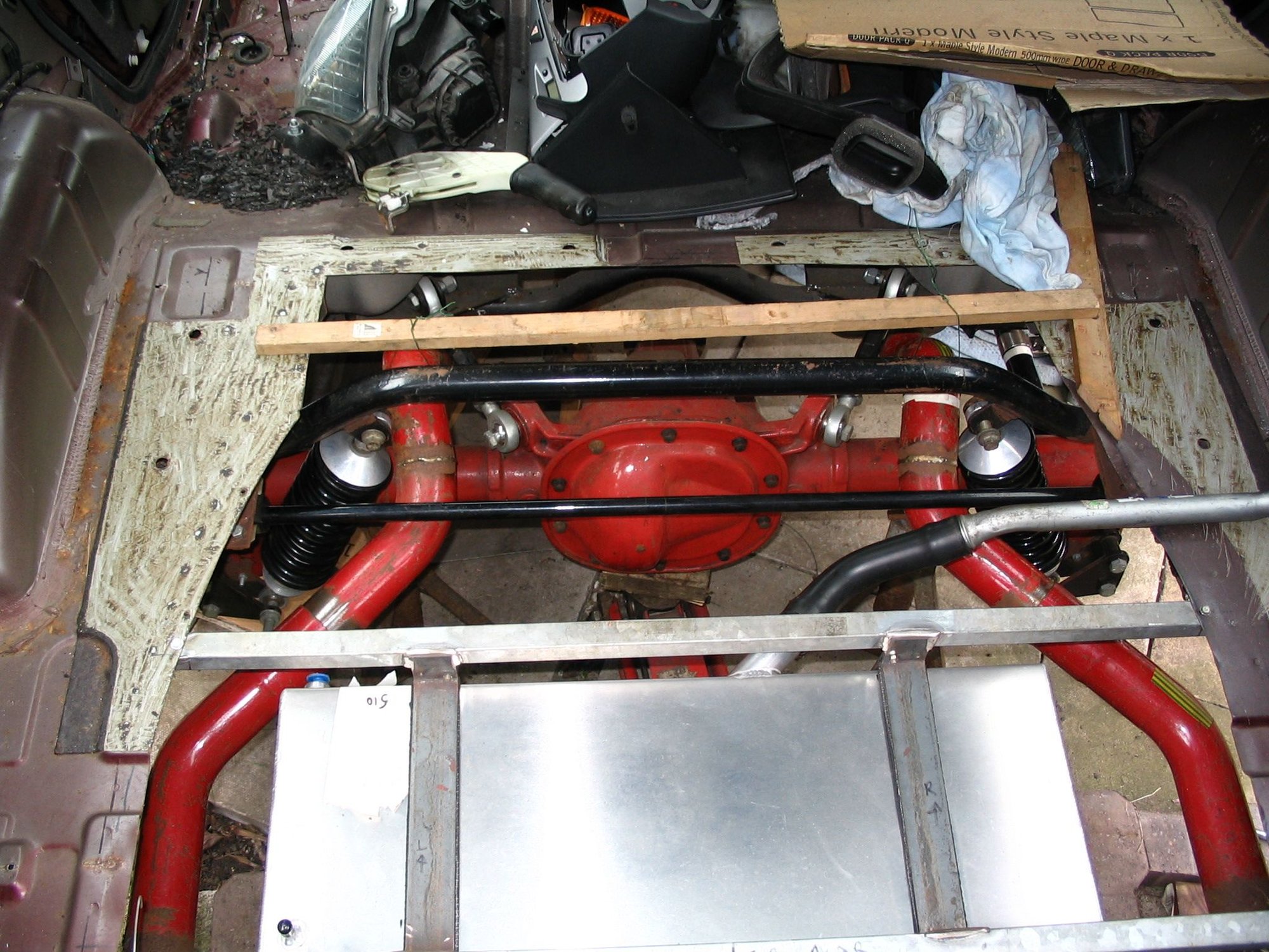

Didn't realise you were so far on with it.
I had a Ford 8.8 rear axle as used in Mustangs, converted the brakes to ST170 rear discs and same at the front.
Most of the ironwork for supporting the axle came from a kit made for the conversion in the States.
I had the Fuel tank made locally.

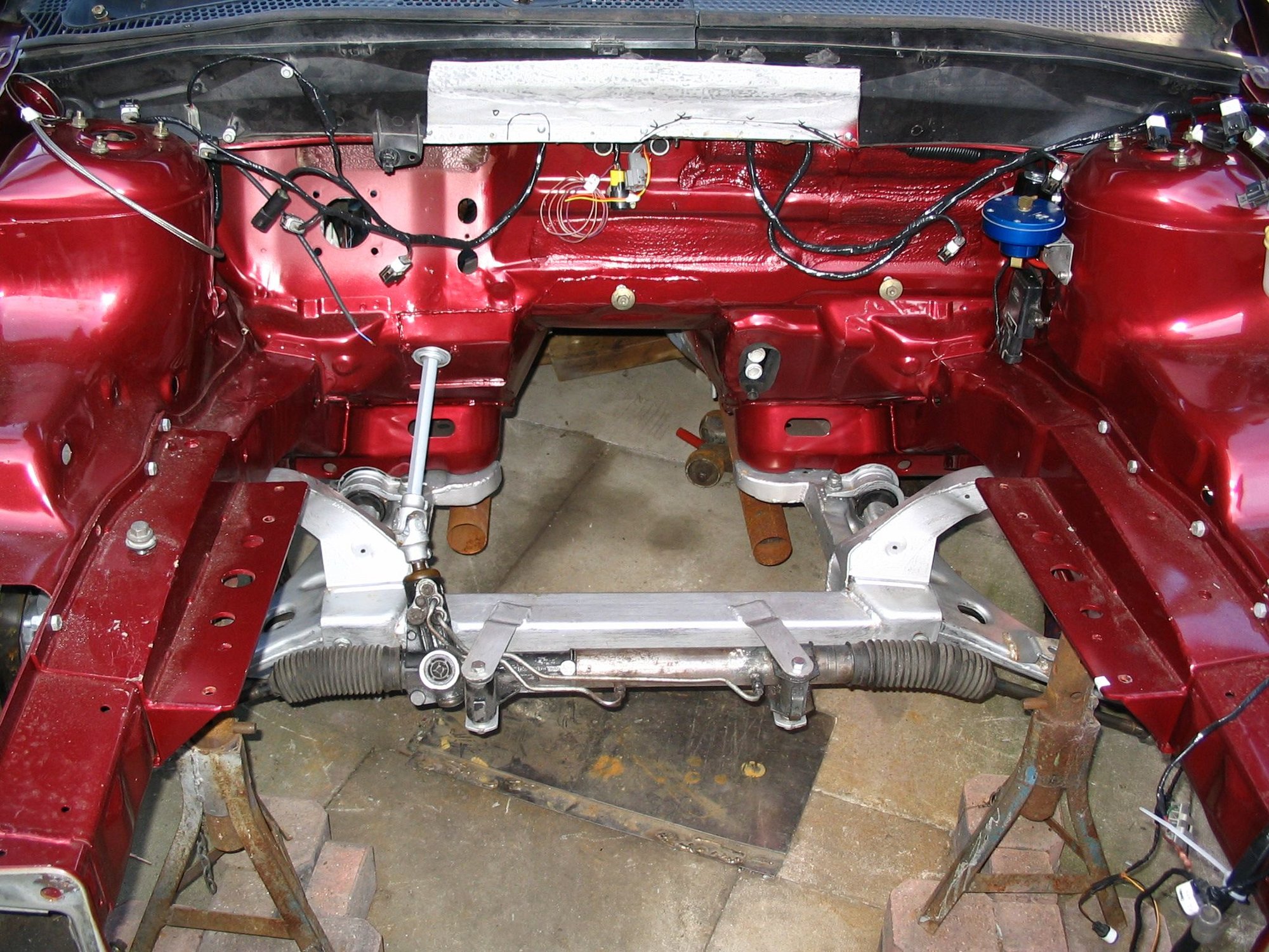

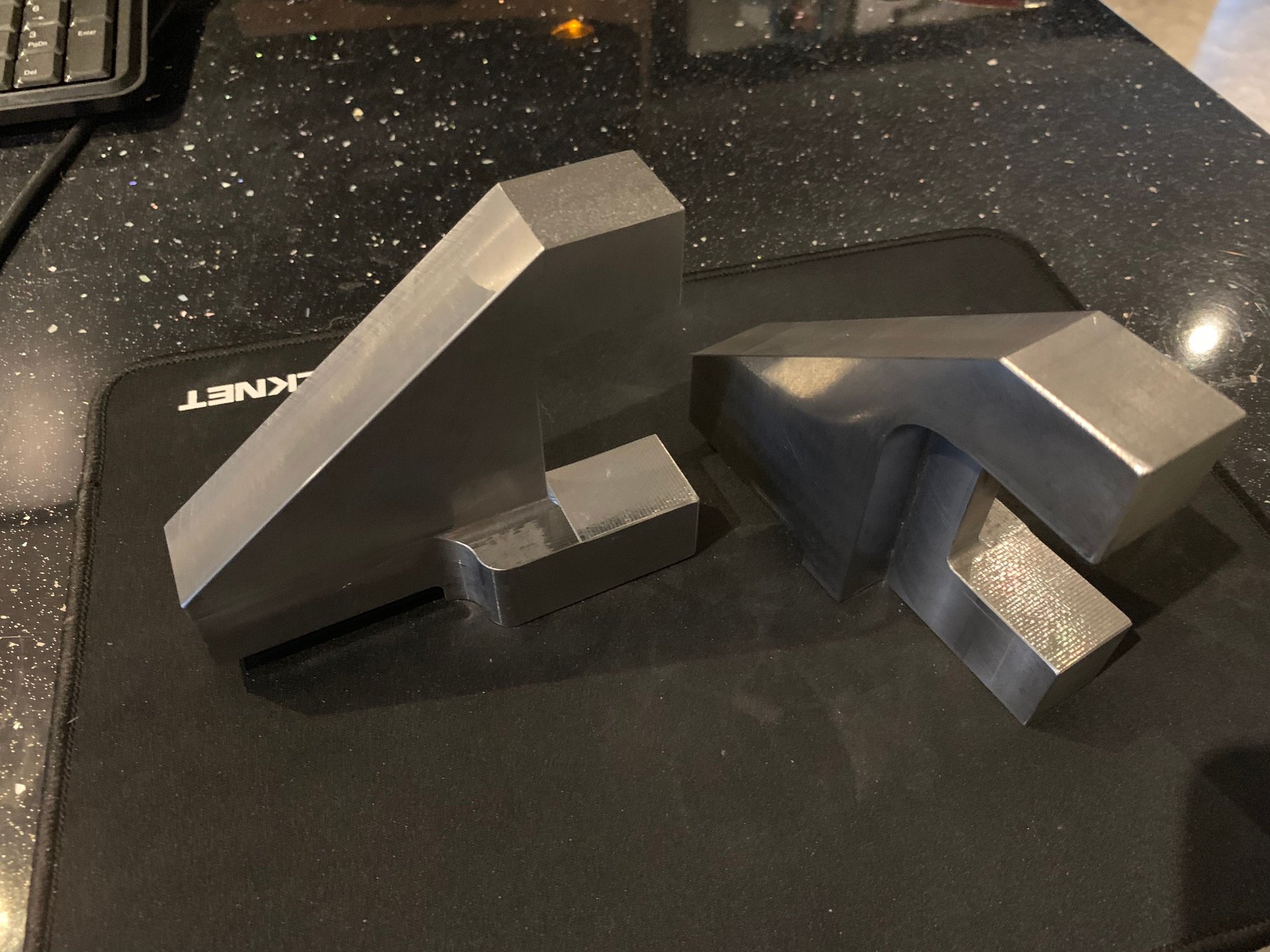

Cosworth 4x4 rack, original subframe altered, similar to yours, but I wanted to remake it in tube.
St170 Knuckles /calipers discs.
CNC'd Adapter block from the USA to correct the Track rod location. (wasn't happy with that)
Swoped left and right struts so the steering arm faced forward.
Nice! Your tunnel doesn’t look anywhere near as large an opening as mine.
what weren’t you happy with with the steering blocks?
I measured and made my own...
but have pretty much the same setup
Old Oct 5, 2019 | 11:41 AM
focusv8's Avatar
focusv8
Posts: 4,773
Likes: 86
From: Nottingham
It was the look of the block more than anything, but didn't like having to use rose joints instead of a ball.
But your's looks very similar
Picture (not very good one) of a dash mock up I was trying, with general purpose gauges.
Old Oct 5, 2019 | 11:45 AM
Jaff.'s Avatar
Jaff.
Joined: Oct 2019
Posts: 33
From: Swansea
Yeah don’t think I have any more choice other than to use a rose joint. I’ll be putting a rubber boot over them though. Not ideal but not totally out in the elements either.
That dash is a pretty good stand in for a normal one. Wouldn’t mind that as maybe a last resort or something
I don’t know I’d rather get the standard stuff working lol
