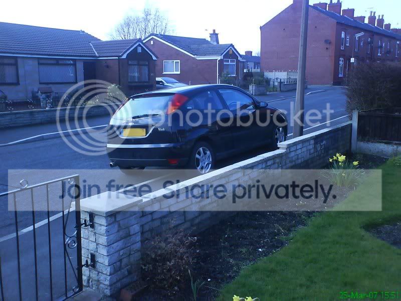

I only know because I had the same problem. Not sure on a price mate sorry. Nice car though.
Old Apr 3, 2007 | 11:01 PM
timbo_69's Avatar
timbo_69
Joined: Mar 2007
Posts: 58
From: huddersfield
yea i love the car. just bought some white alloys should get them friday

Old Apr 4, 2007 | 12:03 AM
GazzaG's Avatar
GazzaG
Posts: 16,383
From: Manchester
Black car White wheels, sorry i'm not keen on that combination at all tho i'd have to see it done
Old Apr 4, 2007 | 12:06 AM
timbo_69's Avatar
timbo_69
Joined: Mar 2007
Posts: 58
From: huddersfield
i'll get pics of it up asap but just remember still have to get in lowerd and new bumpers on
Old Apr 4, 2007 | 12:31 AM
Benni's Avatar
Benni
Ban[B][/B]ned
Posts: 34,090
From: The Pool.
Gaz, White wheels and black car can look good. What bumpers mate?
Old Apr 4, 2007 | 12:32 AM
timbo_69's Avatar
timbo_69
Joined: Mar 2007
Posts: 58
From: huddersfield
frs style and not sure for rear yet
Old Apr 4, 2007 | 01:13 AM
GazzaG's Avatar
GazzaG
Posts: 16,383
From: Manchester
get collection bumpers mate
