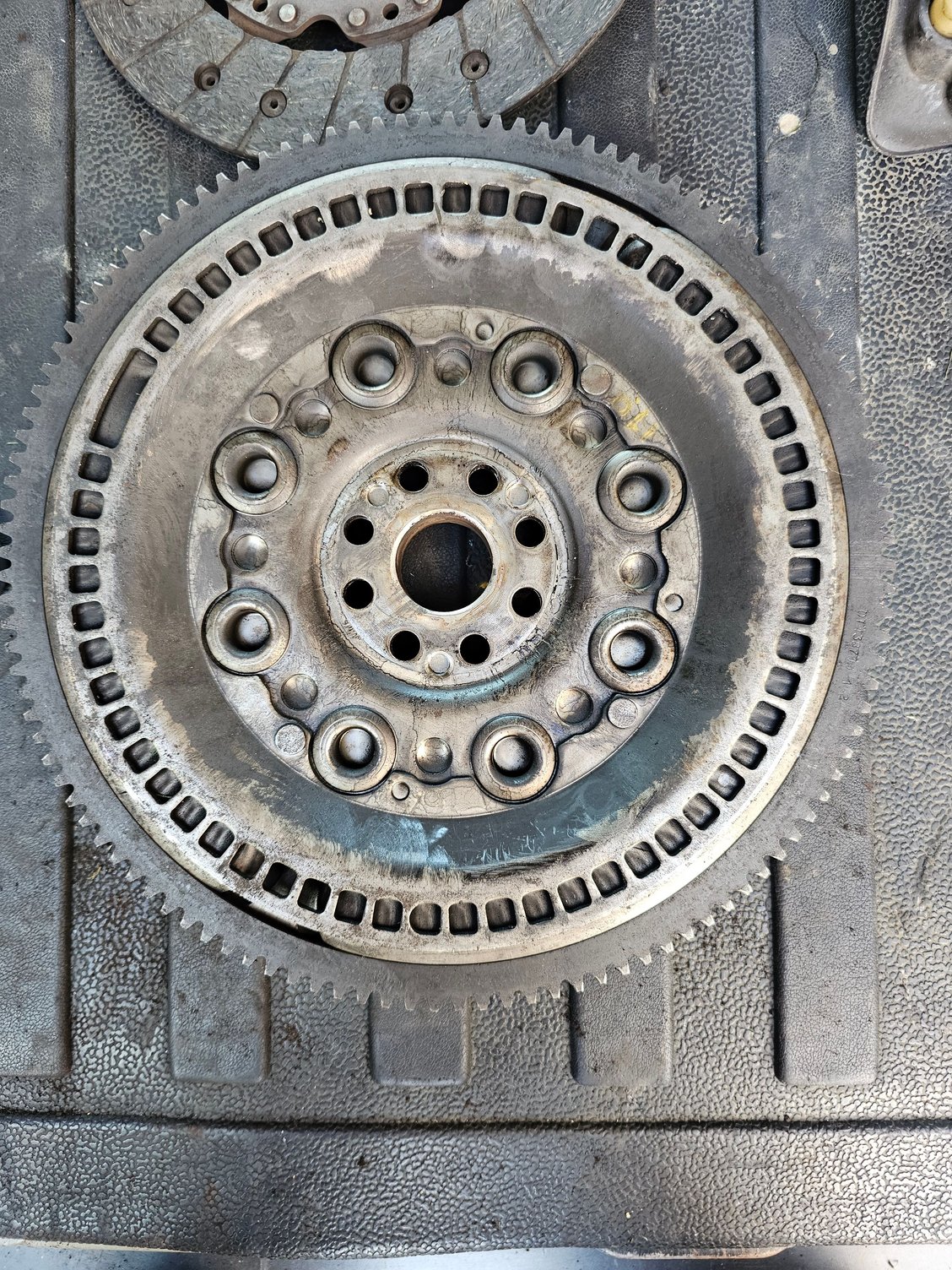

Hi can anyone help please I've had a new clutch fitted on my diesel 2008 Ford focus 1.8 I've had it changed from a dual mass to a single mass flywheel with all the necessary items to convert it to a solid mass but now the car won't start I was told could be the crank case sensor so brought a new one still no joy tried easy start it started but over reved and then just cut out again and still no start all wires etc are correct and present I've been told could be the flywheel as the new one have teeth on the back for the semsor but old one is a square ring type would this be the case or am I missing something only surly it would still work as its sold for the car?

should be same but has that flywheel you fitted got the pick ups on for sensor

Thats what came off the car
This is what the new one is like new one has teeth but the other has squares on a plate

Do there have the same amount on them tho? and are there in the same place for pick up on engine were sensor goes?

is the distance on the sensor to the ring the same on both .you may need a diff sensor maybe
