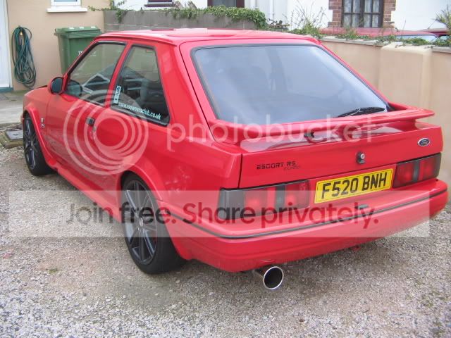

well long time no see i need my car to start and well it doesnt
its been intermitent now just doesnt start advertised it on ebay best offer was 700-800 quid id rather keep it and do the work but if it doesnt start cant get it to a garage to sort the overheating
any ideas on what could be the problem ??
ive checked all normal things batterys good almost new turns over but doesnt kick in stutters kinda also when i did get it running it would run fine for 15-20 mins then boil over fan kicks in fine and temp just gets hoter not sure really where to start any guidelines ??? first port of call ??
