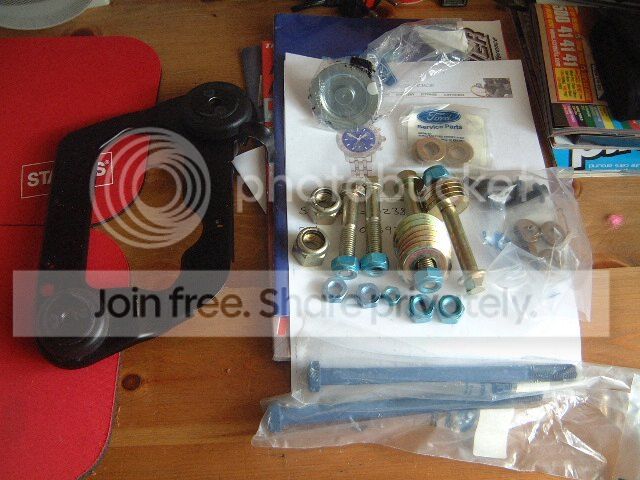

you need to cut both bolts i think i slid the hacksaw blade in the top of the rubber mount then cut both off the boot one then will be fecked a you need a new one from ford and it will need painting the other one any bolt long enough with two nuts is ok
the new boot bit can be seen top left of bolts in pic, get a new pump mount plate at ford when you there, think it was 25 notes

Well, what I needed (or "think" i needed so bought anyway )
1 x mount as bodge has pictured at the top
1 x bootwell plug again as pictured by bodge
3 x the rubber moun things, as you say dont come with the nuts it seems...
3 x nuts, assume these are for the rubber mounts, not sure yet
That's all i needed as I have the other mounts from AS which look cool, I will take a pic when it is all assembled again
