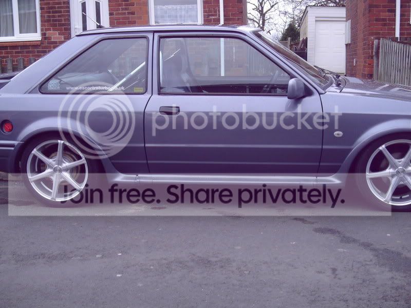

i have 215's on mine, but had to cut out the front arch lips with a grinder, they dont catch now but only just catch on full lock. also my car is dropped 60mm on the front
the rear catch also but i aint cut outthe lip yet..
