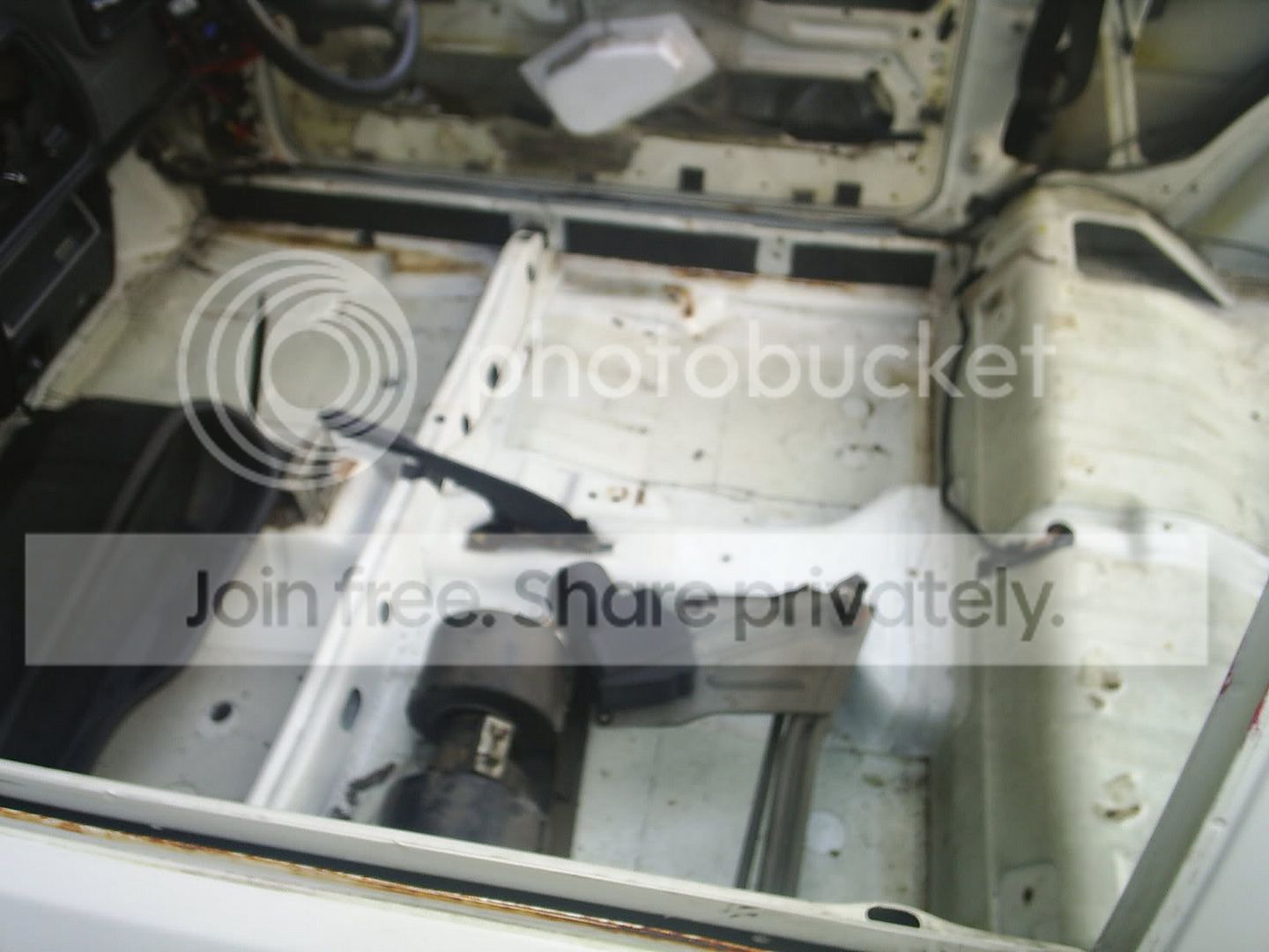

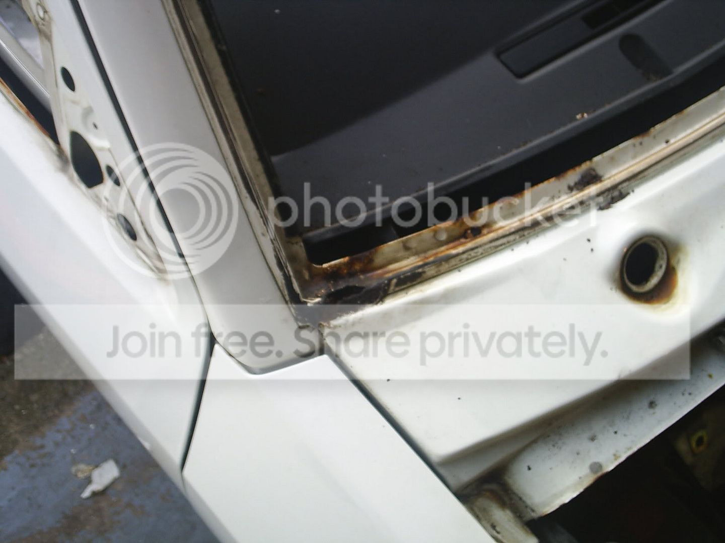

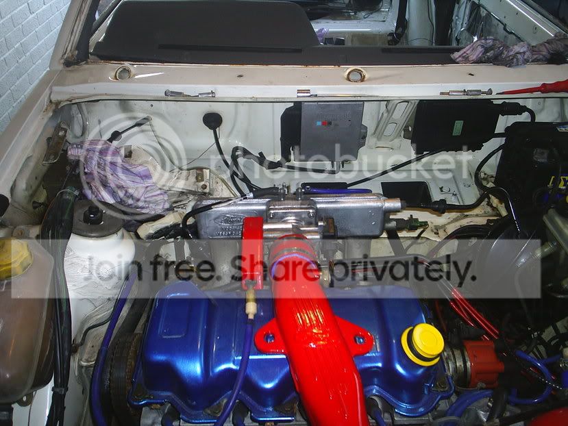

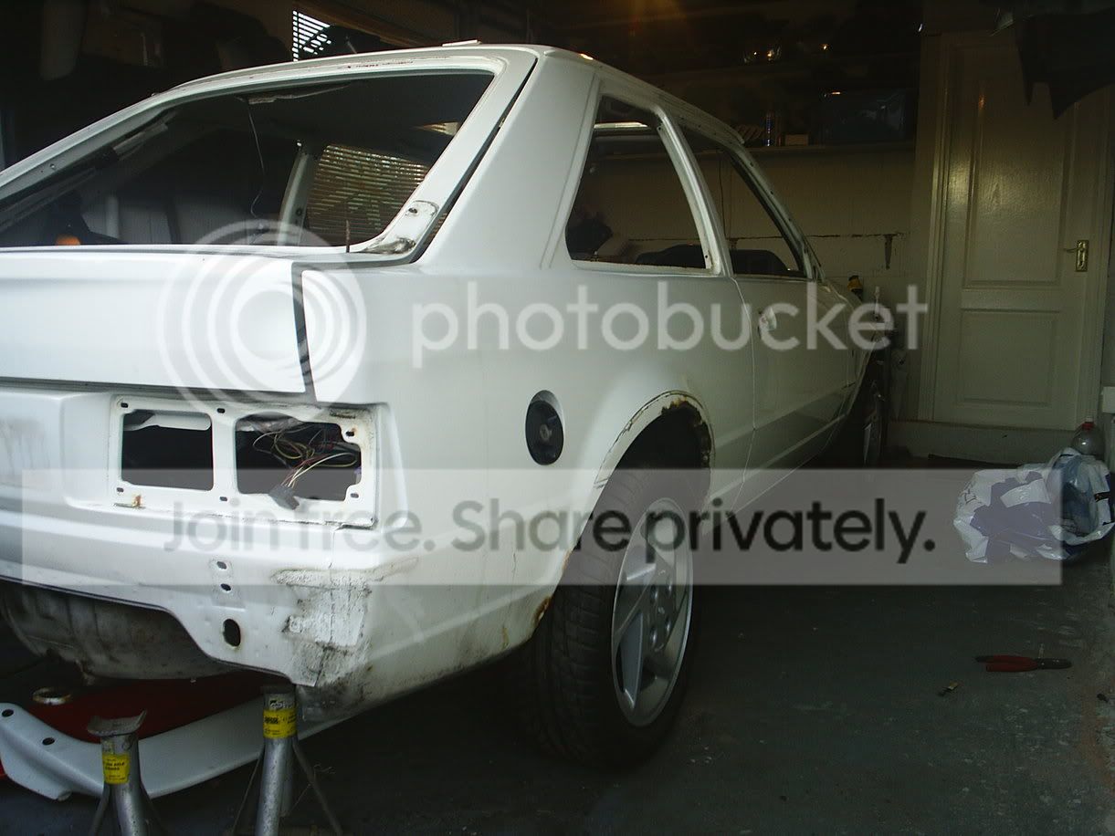

just stripped it what do u think?

needs some work but looks a lot more solid than a lot of RS's ive seen (including mine), check my sig to see mine

Looks like a nice little project there,not too far gone ,keep the updates coming

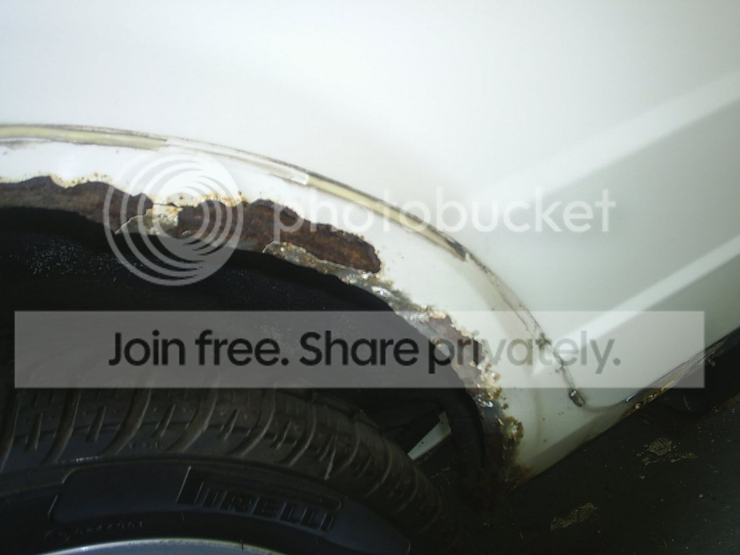

looks good mate, rust in all the right places, keep the pics coming!

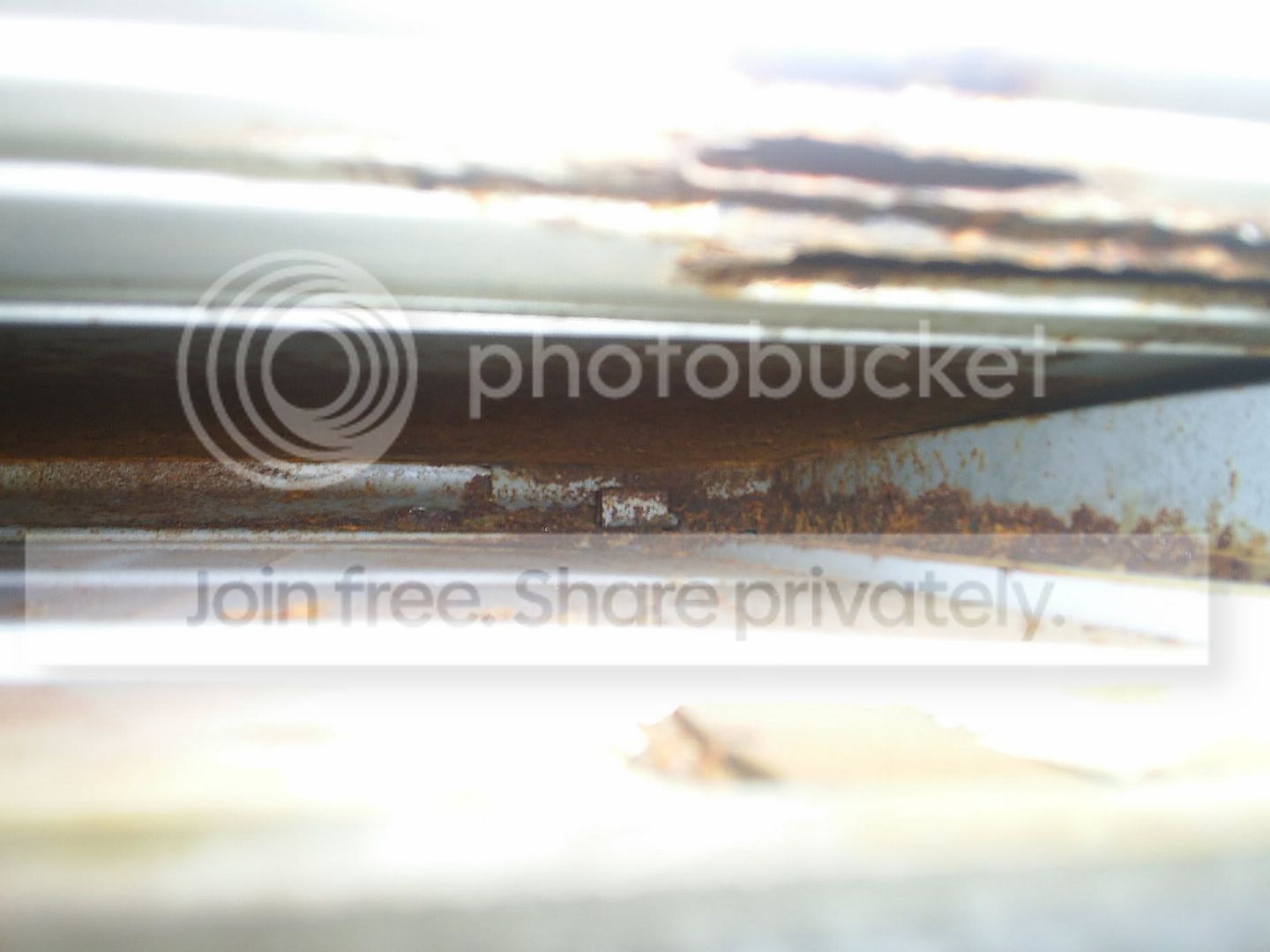

first job is to treat the rust inside the roof, ive seen some good rust treatments at www.frost.co.uk, can any of you lot recommend a good one? cheers ps do u think its worth painting the bulkhead and inner wings?

Doesn't look to bad mate, i've seen worse so you've got a good shell to work with. The link for frost didn't work but i buy a few things from them and this is 1 of the products i use for removing rust http://www.frost.co.uk/item_Detail.asp?productID=8229
For really thick rust i spray it on a leave it awhile then attack it with a wire brush attachment on my grinder

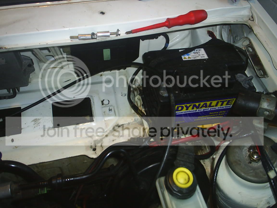

got your work cut out but at least with havin all the kit off etc, you can see evrythin that needs sortin

I use a good rust cure ,its made by a company called granville ,sold in a little pot with an oil rig picture on it ,when we did will,s one (puss on here),his sunroof was the same as yours ,we hoovered out the loose then got a mini roller with the rust cure on and painted inside the roof and the bits we could not get to we used a squirty bottle with it in ,Yep would paint the inner wings and bulkhead aswell

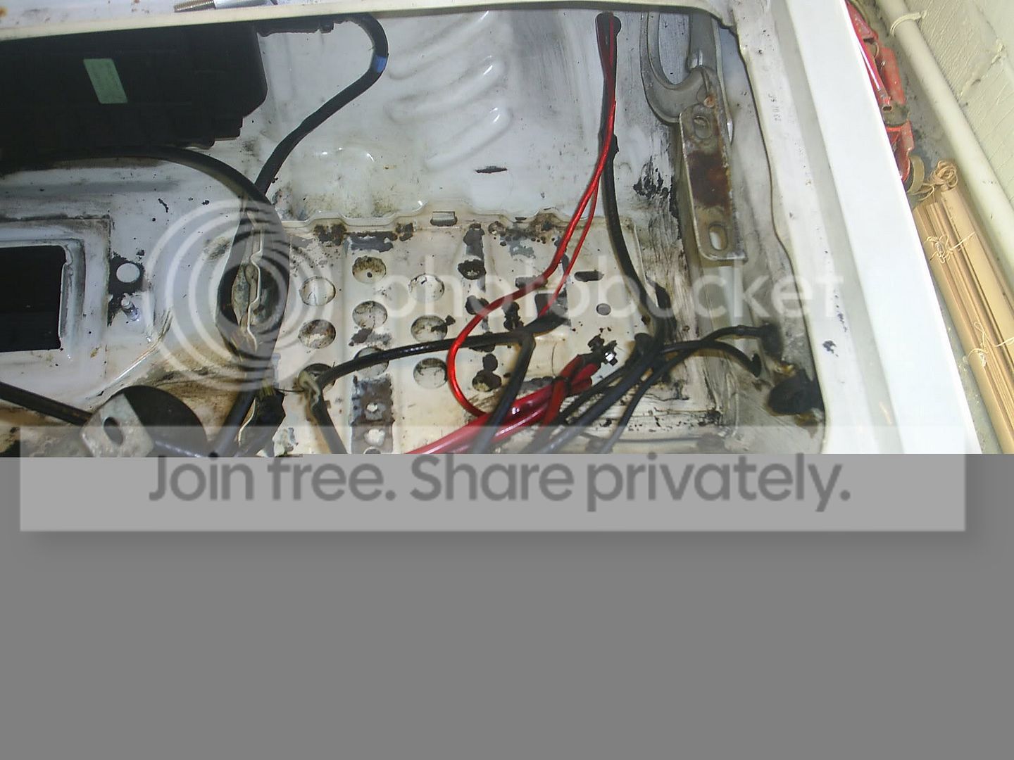

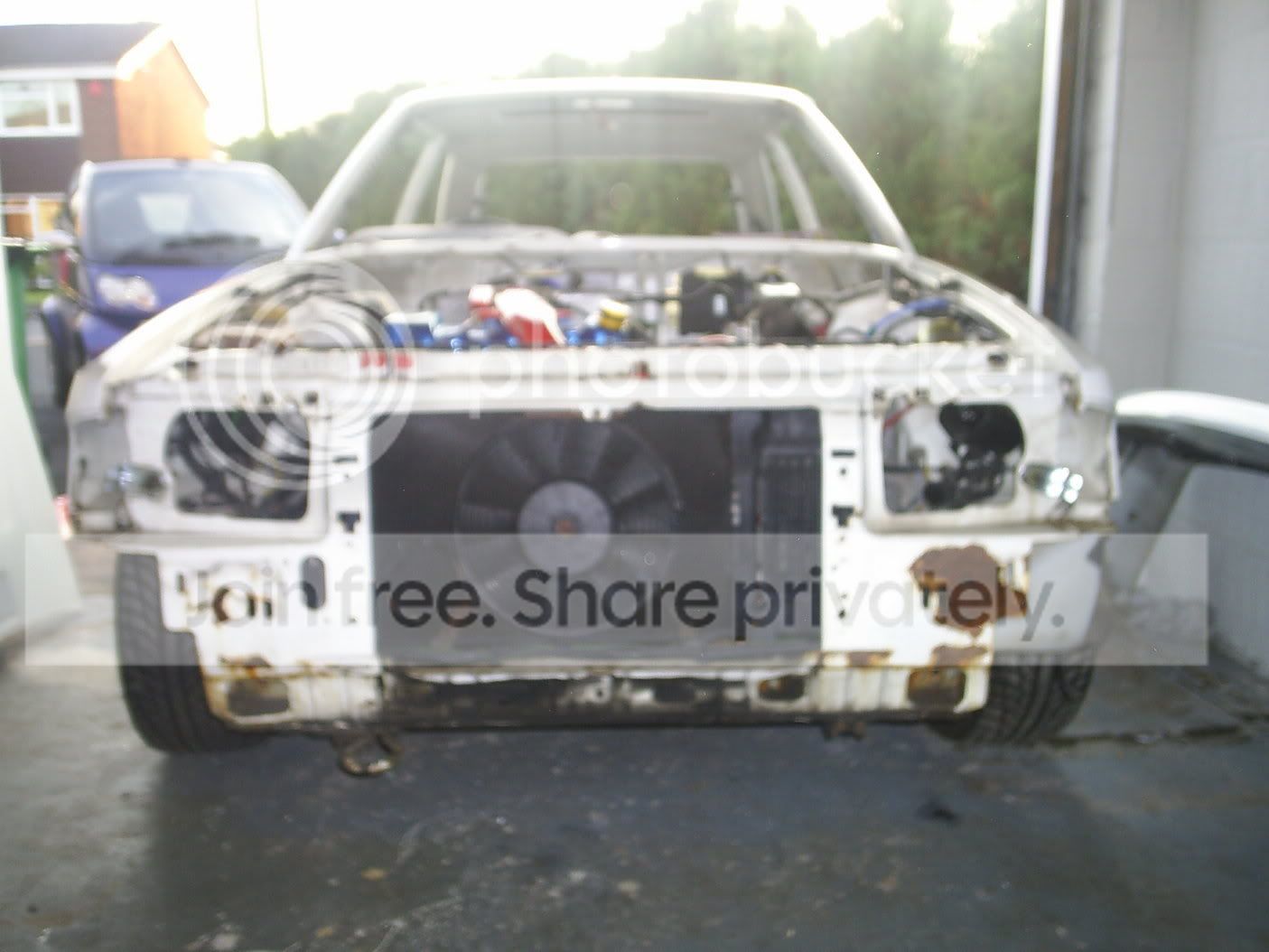

hello people sorry for the delay with the up dates but ive been a busy lad!!!, all the welding is now done so im filling/repairing for primer at the moment, the worst job was the roof, once id got rid of the rot i had some pin holes which i had to weld up! but ive gone to town on the rust proofing on the underside using POR 15 metal ready which is a type of acid to neutralise the rust then i used black POR 15 rust encapsultor which is absolutely permanent, it seals in the rust forever!, its used in the marine industry and is guaranteed to be a permanent cure for surface rust,it comes with a warning on the tin that if u get it on your skin only time will remove it!!!!! after this i gave it a coat of white hammerite over the top, once its painted i will nuke it in wax oil aswell. once its in primer i will get some more pics up any comments would be appreciated

looks good mate , front end looks nice and solid , (unlike mine )
keep up the good work and get some pics up when its in primer
