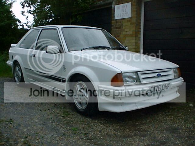

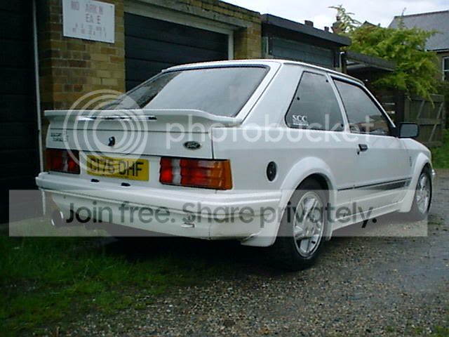

Yep its Thrushs old S1 brought for £1100 after much hagglling!! lol

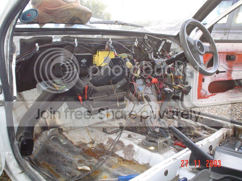

It dont look to bad in the pics but did have damage to the N/S door and as i latter found out quite a lot of rust!!! But i knew it was not mint hence the price.
A week after getting it home and its stripped
And the floor pans are being replaced
Flintstone style, should get good MPG and dry use only!! lol

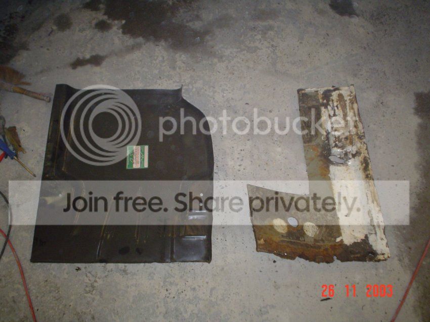

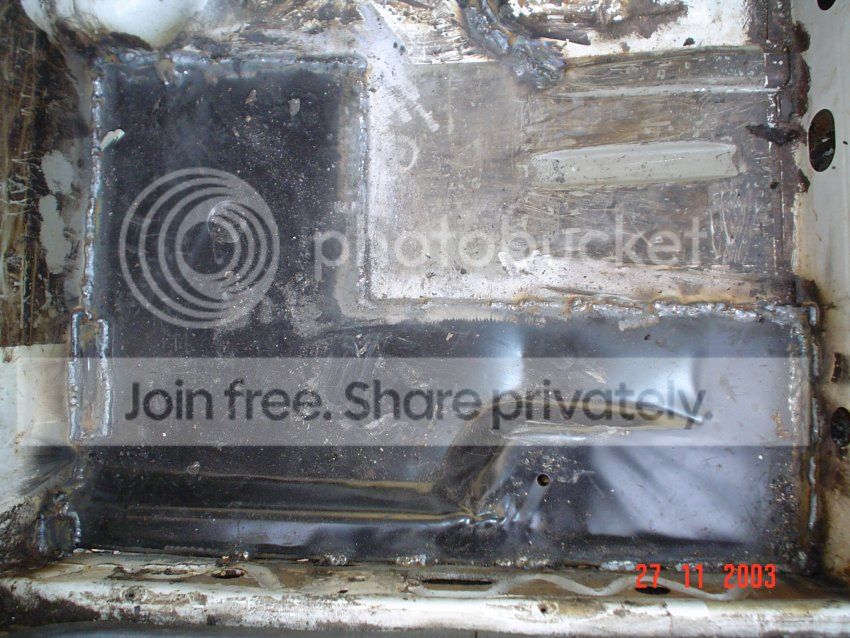

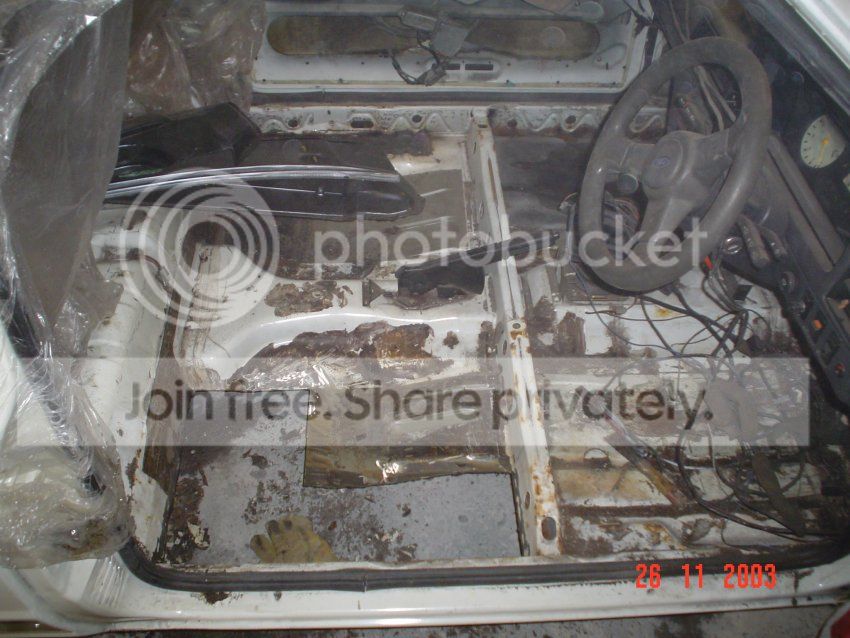

The old and the new floor waiting to be cut and welded in
And the floor pan all welded in thats 3 done now, one to go
Thats it for now, i want to try and finish the floor this comming week and also need to drop the fuel as it needs welding under the rear seat.

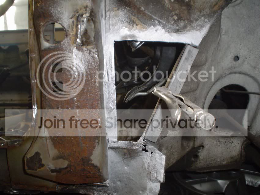

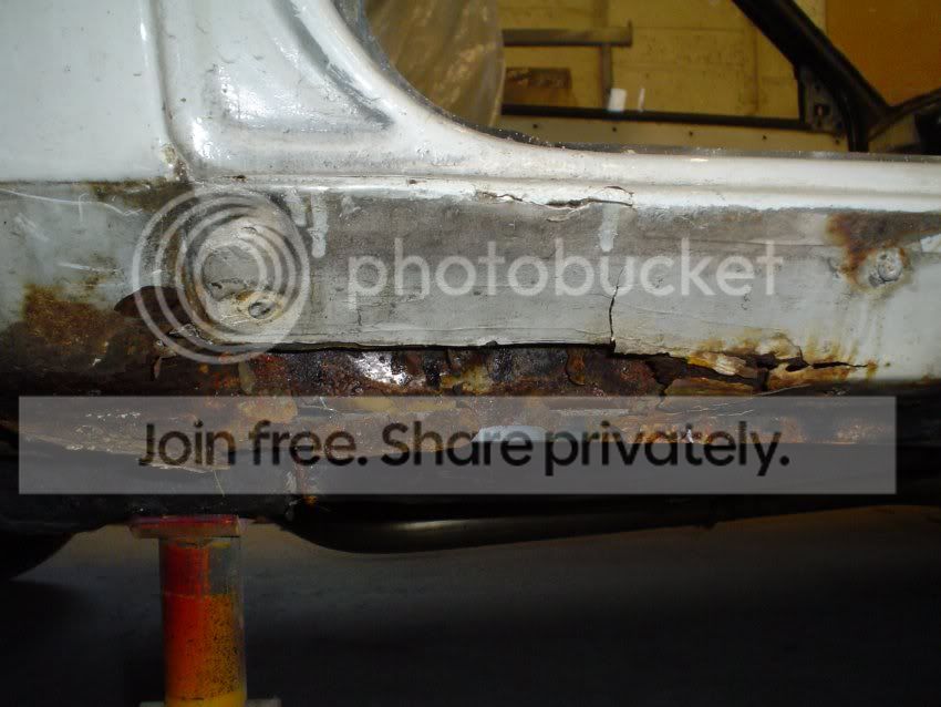

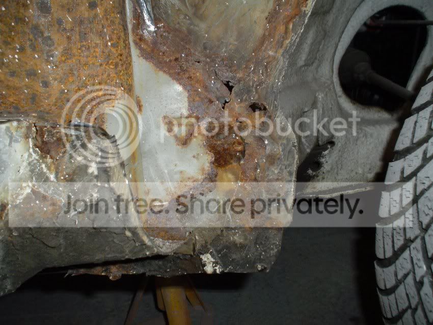

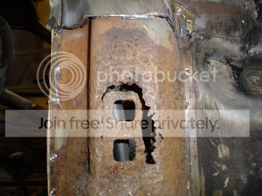

The outter sill is really rusty, its all got to come off
Once the front of the sill and the outter a post had been taken off it showed how rotten the inner sill and bottom of the inner wing was.
Just shows how rust hides away, you could not see any of this with the outter skin on
No wonder the door did not close very well, iam suprised the door did not just drop off when it was opened!!! lol
Here i have cut all the rusted metal out of the lower inner wing and about to start welding it all back together.
Should have some more pics soon.

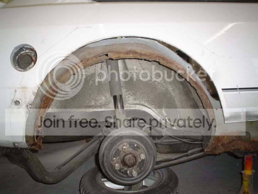

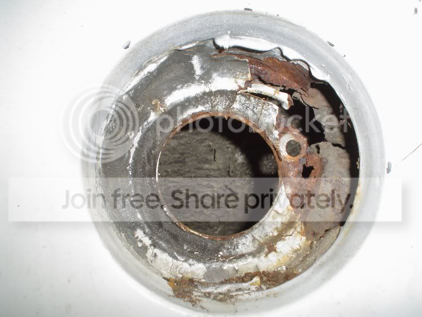

The filler neck is well rusty and you do not get this panel unless you replace the whole rear wing so i will have to make one up.

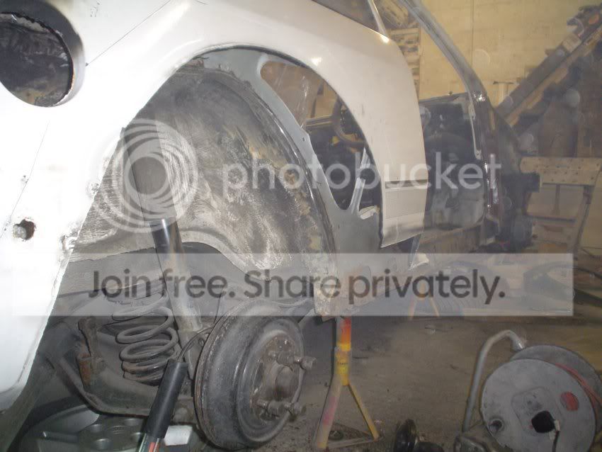

With the outer arch removed it shows how rotten the inner rear arch is, its all got to be replaced.
The inner arch all removed to, should be able to get some massive rims on now!!!!! lol Only joking!!

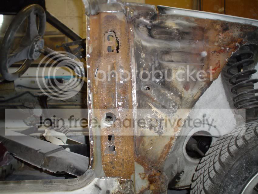

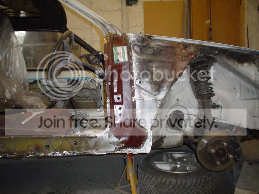

With the repairs all done on the inner A post time to put the new outter skin on.

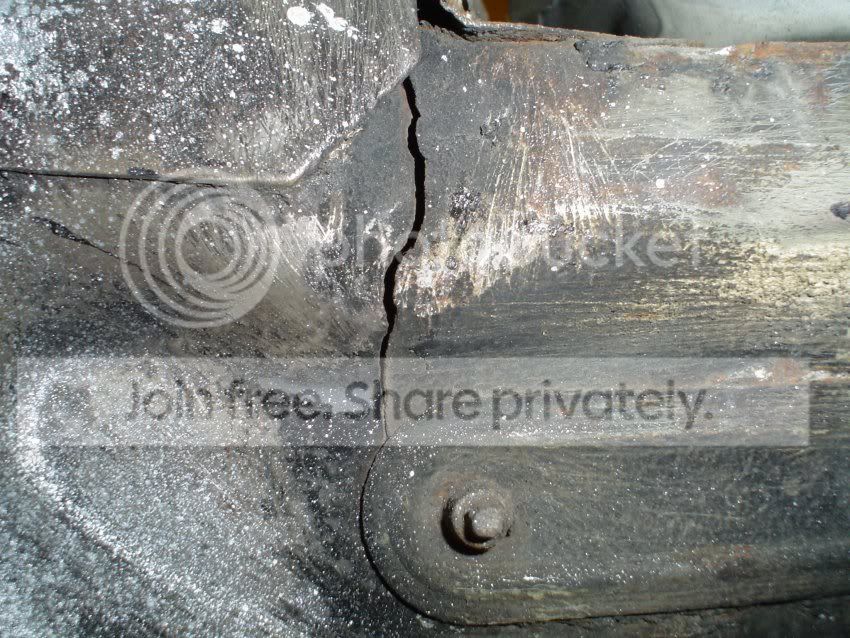

Another job that needs doing is to replace the rear sections of the front inner wings, as you can see theres a massive crack there!!! Nightmare!!!
Me in "action" lol!!! Welding the outter sill on, at last its starting to look a bit more like a car this side, just the other side to do now!!! lol
