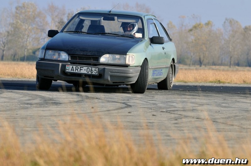

no changes with the car yet, but i was racing her in an event called minirally. around 5km stage on an airfield, 3times, worst time deleted. because of the non-factory engine, i was putted on the higher class, but finished 6th between M3 and V8 bimmers, evos. makes a few mistakes, no slicks just used road tires, plus half litre oil in the engine and that was the setup for the race
the car is not ok
i lowered the turbo pressure to 0.6 for safety, hydro handrake isnt working so the hairpins and the slidings are killing me... the car wanted drifting when the pressure comes, slided at brakings, so sideways all time but we were enjoying the first time together on the track
pix links and videos coming soon, i think people there was a bit high or drunk because they liked my "chicken" driving
