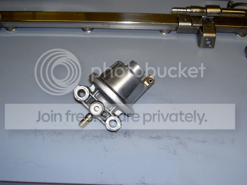

heres a 4x4 fuel rail
heres the reg

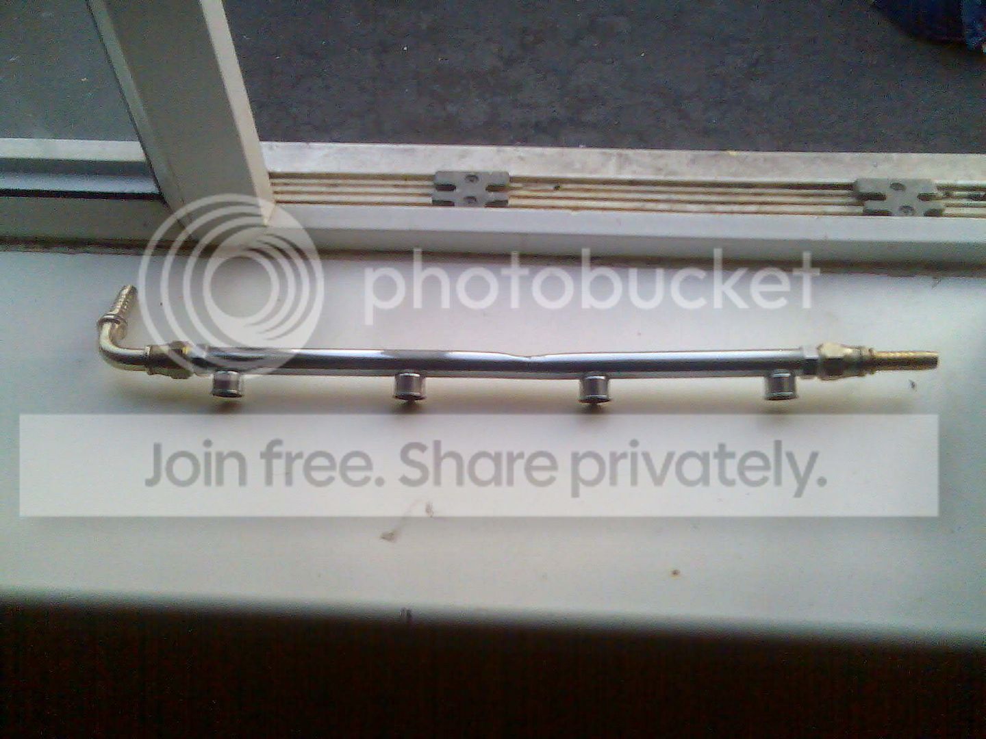

im ok useing top and bottom reg connections, as hoses attach to these its just the o-ring part i need to find a way to block it up if poss? or will i need to use it?
heres my current fuel rail on my zetec
any ideas?
if the saffire 4x4 rail would fit ok, or ideas how i would fit this ?
heres the reg
any ideas?
heres the reg
any ideas?
heres the reg
any ideas?
You really need to sit down and think abour how a fuel pressure reg works. You need all connections!! And to the right place. At best your car will not start, at worst you will set yourself/garage/house on fire!

Im afraid i respectfully advise you to have a professional finish this job pal, your lack of knowledge on this subject is going to put the passengers in this car at risk. 10bar of fuel is not to be bodged with, especially in teh vacinity of a 900C exhaust manifold.
Sorry to be blunt but it needed saying.

im useing the 1.8 zetec efi inlet,
i do understand the pressure system is just
the engine is finished as built it all myself, just the regulator i need now,
i orded a cosworth one but dident know about the o-ring connection, as my custom fuel rail does not have the o-ring connection to house the regulator.
