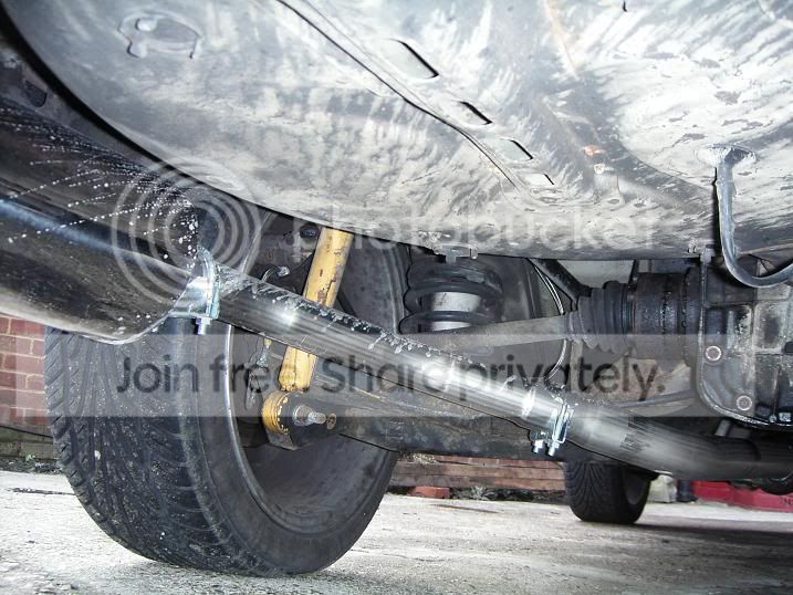

this is the normal sierra exuahst routing
note that the pipe gooes round the side of the wishbone
this is the only pic i've got of the car i binned the exhaust off of
so i can't show you the double kink in the exhaust where it goes around a secondary bit of the rear wishbone, i should have one by the weekend though
this isn't to say that ALL exhaust will have this problem, as you can see, one exhaust has been bolted on directly without a problem, but it's not always the case

Well chaps, i have just refitted my mates new Mongoose exhaust to his twin turbo est as he fitted it with his eyes closed It does sit close to the wishbone but it does clear and it sits in the right place out of the bumper. The only difference on the estates are the bulges on the wishbones for the bump stops. We nearly put a custom curve to give added clearance but with strong exhaust rubbers its fine Have got about 1/2" clearance from the wishbone
