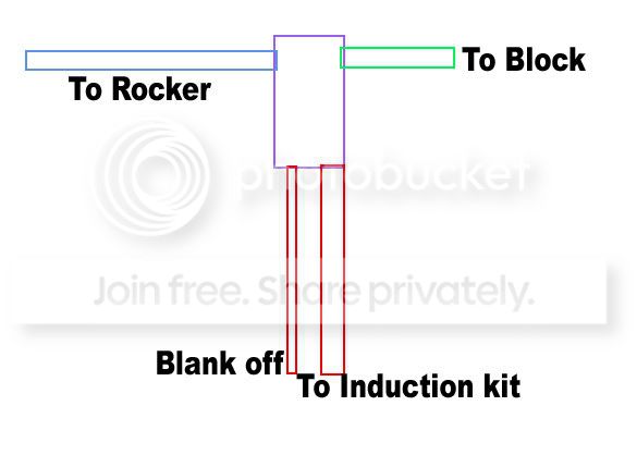

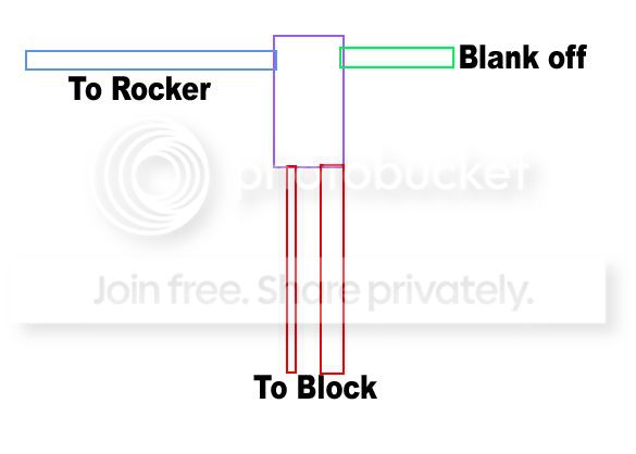

Hi, im thinking 2 options for my breather on my zetec turbo
option 1:
re-circ breathing to the inlet system or one of the little piperX filters- i dont know which would be best?
option 2:
drain back into the sump
Whats the opinions of you that know?
Its using a Bailey Sierra Cosworth breather tank.

from block and cam cover, and have thing vented to atmos, or return to sump if you wanted.
personally i will prolly just vent to atmos
