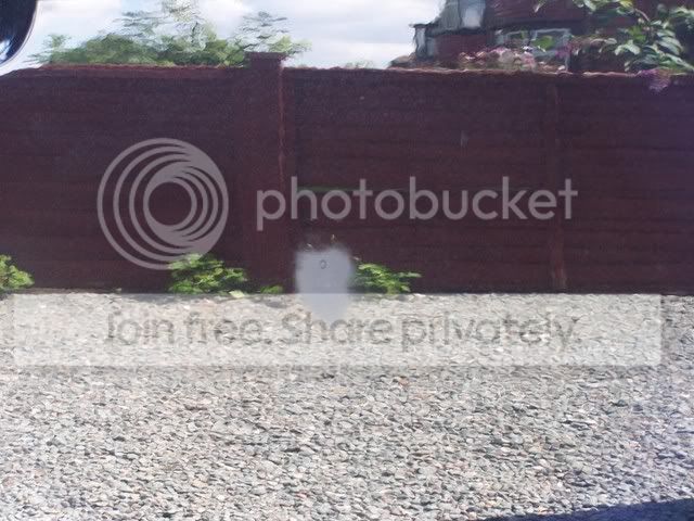

the car has took its toll of supermarket trolley hits and the next door mowing his lawn and flinging a stone into the drivers door, plus some neglect during polishing up at shows so I been busy doing a little correction.

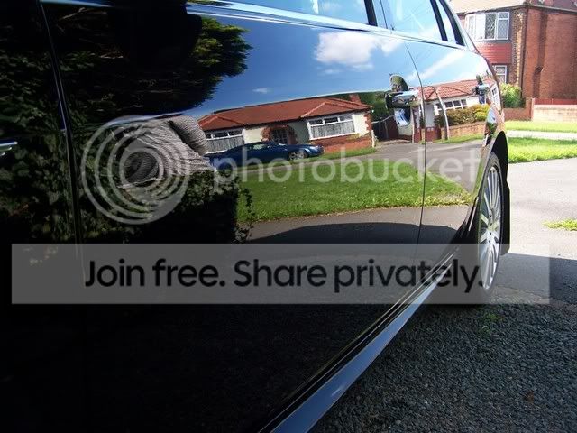

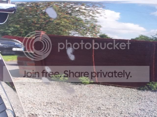

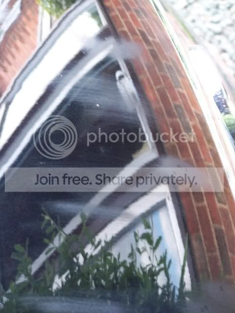

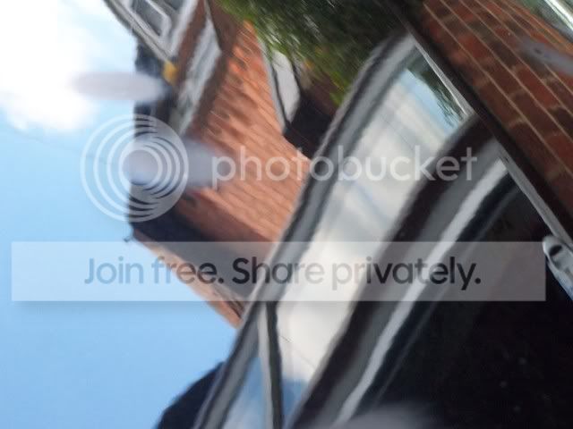

some wet sanding on the drivers side doors after touching up with paint

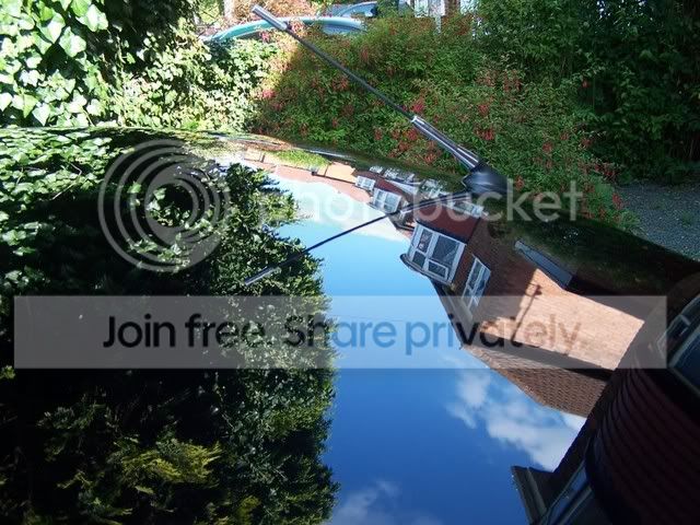

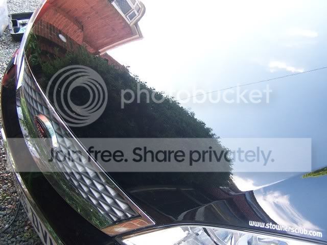

stone chips on the bonnet
all corrected out with the Megs 220 using a Sonus 4" spot pad and SSR 2.5 swirl and scratch remover
bonnet after

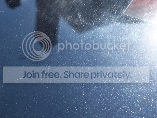

Then the whole car has been gone over with the megs 220, a lake and country orange pad using Lime Prime to get rid of the swirls

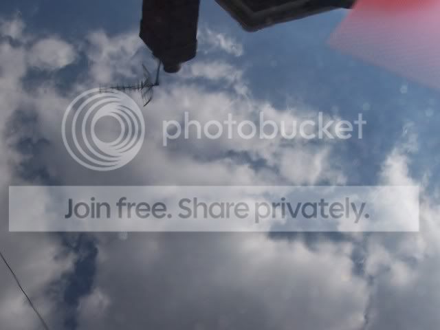

swirls on boot top

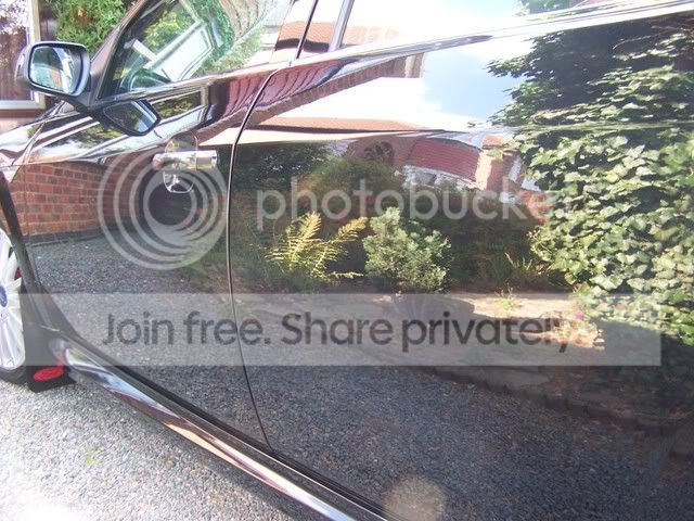

and after
all finished off with a coat of HD wax

What did you do with the stone chips mate, just touch up with colour then wet sand back then use ya megs 220 to cut then polish out the swirls and blend it all in ?
