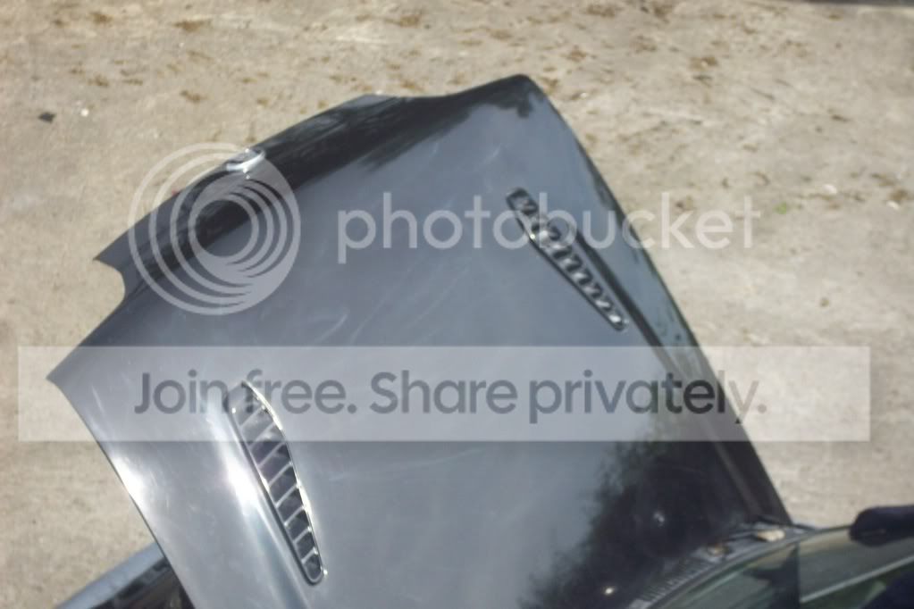

heres the prob
am using g3?

All you need to do mate is get a soft waffle head and some 3m fine cut compound or 3m ultra finna (sp!) and go over it again with your mop on a slower speed. Job done.

Thats marring, although its called a few different things.
Its where the compound hasnt been worked for long enough for it to "polish" after its done its cutting work. OR, its where the pad and compound choice are to aggressive for the paint.
Either way, it just needs finishing with a less aggressive pad and compound combo

I believe G3 is a constant abrasive, ie: the abrasives do not deminish down. It is also a very harsh compound and as such you will need to go over the paint again with a less abrasive polish.
Start with a finishing polish and if this does not remove the marks something more abrasive will be needed then again with the finishing polish and that will come up like a mirror.

To add to the above, what you can see if hologramming, caused by using a coarse abrasive at high speed without finishing down properly. To remove it, polish the panel again using a very fine finishing polish and a soft finishing pad. Also, you need to use the zenith method - start off spreading the polish at 900rpm, then up the speed to 1500rpm to work the polish and break it down, then finish off with half a dozen passes at 900rpm and zero pressure to refine the finish. Should get you a far, far better result. A great finishing polish for Ford paint is Menzerna 85RE, applied using either a 3M Finishing Pad or a Menzerna Finishing Pad.
