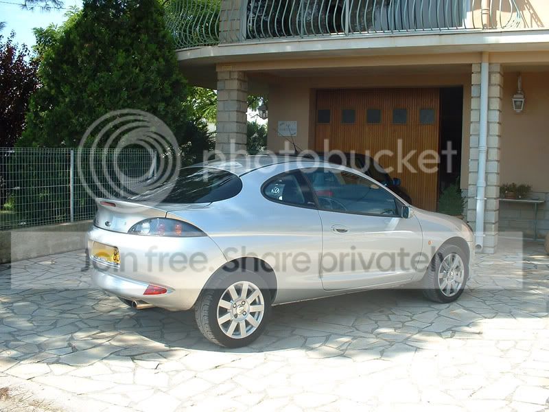

you lucky thing! snow and cold over here!
you obviously drive a puma!
whats it look like then?? got any pics?
Old Feb 25, 2004 | 02:07 PM
Anouchka's Avatar
Anouchka
Posts: 217
From: France, Hyères
sure look at !

nice car!!!!
well looked after as i can see! beautiful weather in the backround to
ive only got a little runaround now
spent most of my money on me bike!! worth every penny tho
are they horse stables in the backround to??
