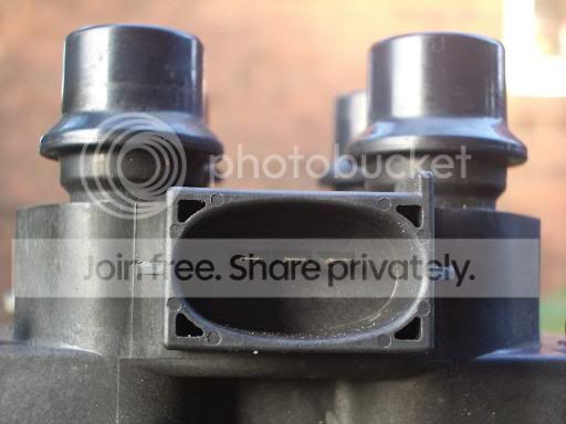

In the pic below does anyone know what the connections are - which one is the 12v feed and which connections are the earth triggers and for which group of cylinders (1+4 & 2+3)?
Old Sep 22, 2005 | 07:16 PM
JesseT's Avatar
JesseT
Posts: 2,866
From: Finland
Center is 12V feed at least.
Old Sep 22, 2005 | 07:46 PM
Moonie's Avatar
Moonie
Posts: 1,190
From: North West
Cheers pal, managed to find out the connections now - centre is 12v feed, left is earth for 1 & 4, right is earth for 2 & 3.
