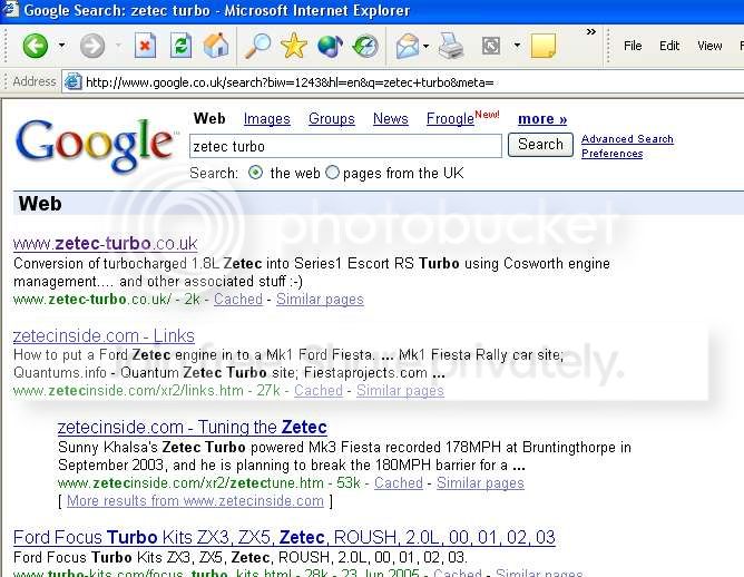

Do a search for zetec turbo on google, a very usefull website.
Well i'd rather have the input from a FORD site instead of google, thats why i posted here.

radiant red's Avatar
radiant red
Posts: 2,384
zetec turbo is a website for the zetec turbo conversion that you mensioned you may be doing.

Old Jun 23, 2005 | 09:31 PM
richm's Avatar
richm
Posts: 3,795
From: Wiltshire UK
still comes up top of the list
