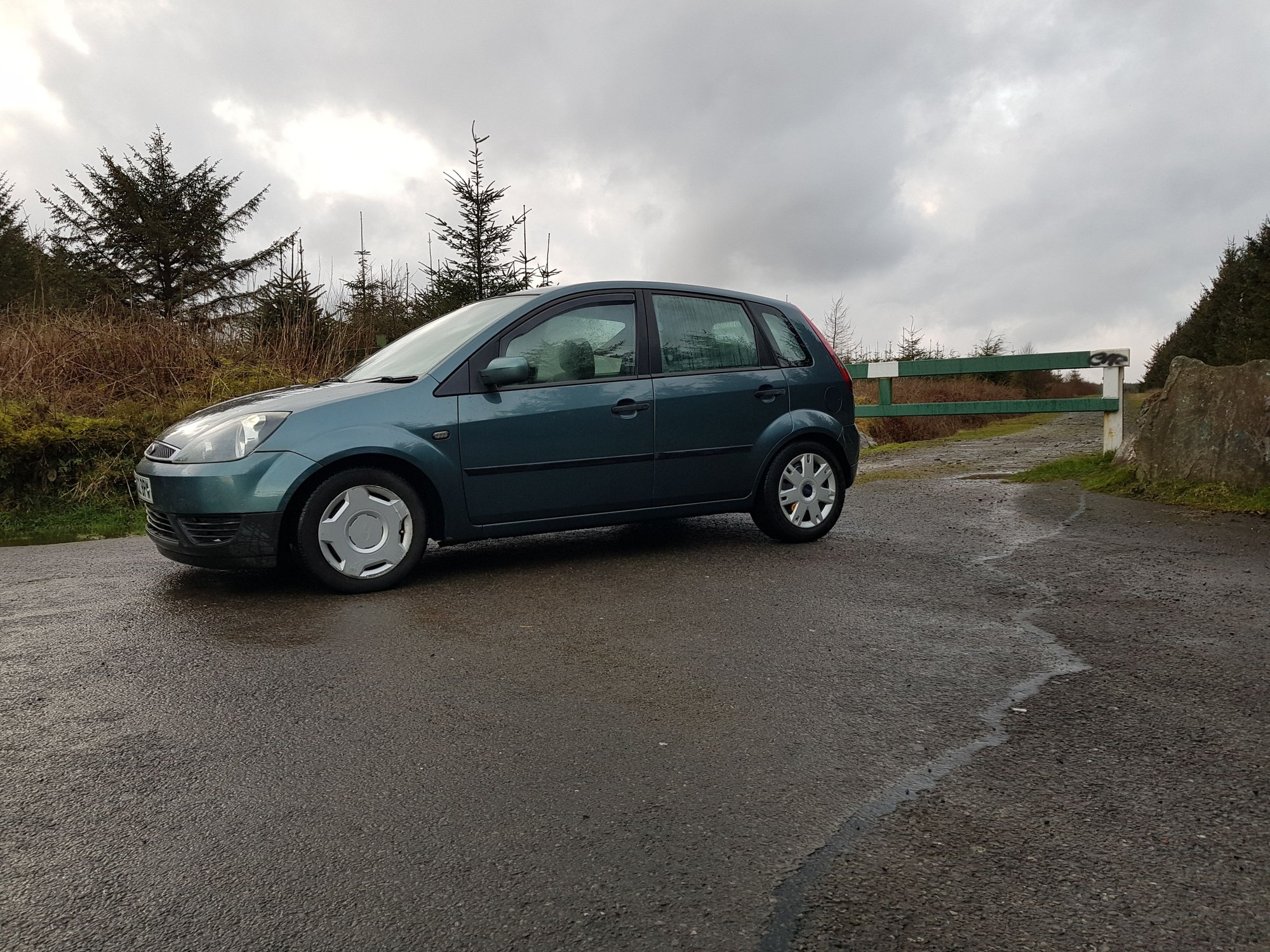

Hi all, not been on here for about 8 years, finally remembered my username,
Anyway a long story short my missues has a 02 fiesta tdci and up until recently been running spot on, I was coming hone from work and the car cut out on me, wouldent restart just turned over then it started hit had no revs, then it wouldent start again, got it towed home and it then started and drove fine, set of to work next morning as soon as it got warm it cit out on me again, same scenario got it recovered home it started up again, once it cuts out tho it will not restart whatever you do and its frying my head,
It's the 1.4 tdci engine Peugeot lump I believe,
I've got it dow to 2 things
Fuel filter this is the cheapest fix
Fuel pump, but on this note would the car be able to start even? It's been sat outside the house over a month now as I haven't been able to look at it but I want to get it running properly at the moment it will start and run but I've not taken it far incase it refuses to start again any help would be much appreciated
