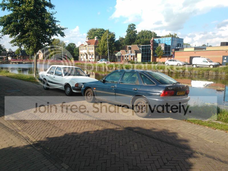

he said that for a Mk4 Escort a Mk6 Escort pump will work but not for a Mk3. It really does not fit on the engine mount...
the donor car is a mk6 Escort:
