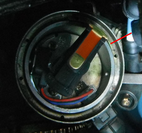

Hey guys,
actually I have a problem installing the distributor on my cosworth engine.
When I first installed it like it is told in the Cosworth manual, I wasn't able to start the engine.
I tried to fire it up and when the engine stops, it turned for a second in the wrong direction.
This is usually a sign that there is a problem with the ignition.
So I tried to turn the distributor clockwise and it went better and better.
But in my opinion, there is something wrong.
I took some pics of my installation:

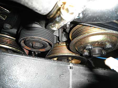

Crank wheel/ 1. cylinder is TDC

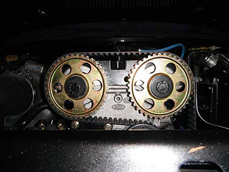

Cam wheels are pointing together

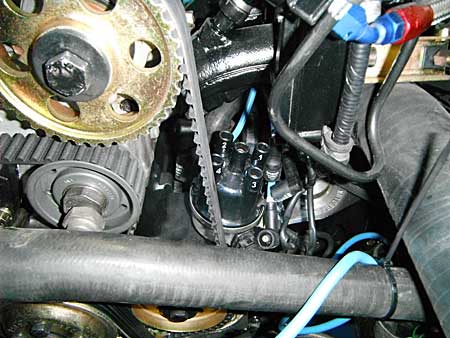

firing order is clockwise 1-3-4-2
As you can see, the rotor doesn't align with the marking on the housing...
BUT... the idle speed is good and also the acceleration...
I am running a P8 Ecu with a program which i don't know and yellow Bosch injectors.
I guess the engine has about 280 hp...
What is your opinion? Please help...
Thanx allot...
Sneer

take out the dizzy og relign it mate its out there in the pic !!

Problem is solved...
the plug of the phase sensor (see last pic) was inserted wrong...
I turned it and now everything is ok...
maybe it can help others with the same problem...
