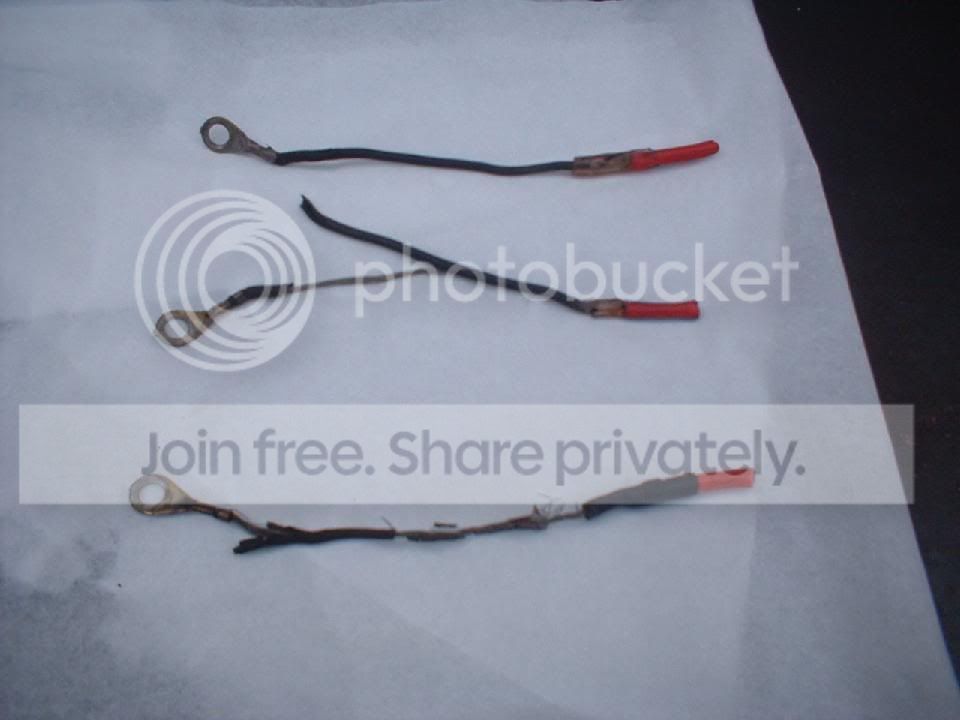

does anyone know if the 4x4 saph cossie have a fusable link the wiring loom. plus what really are they and where would you normally find them in the loom.
cheeRS

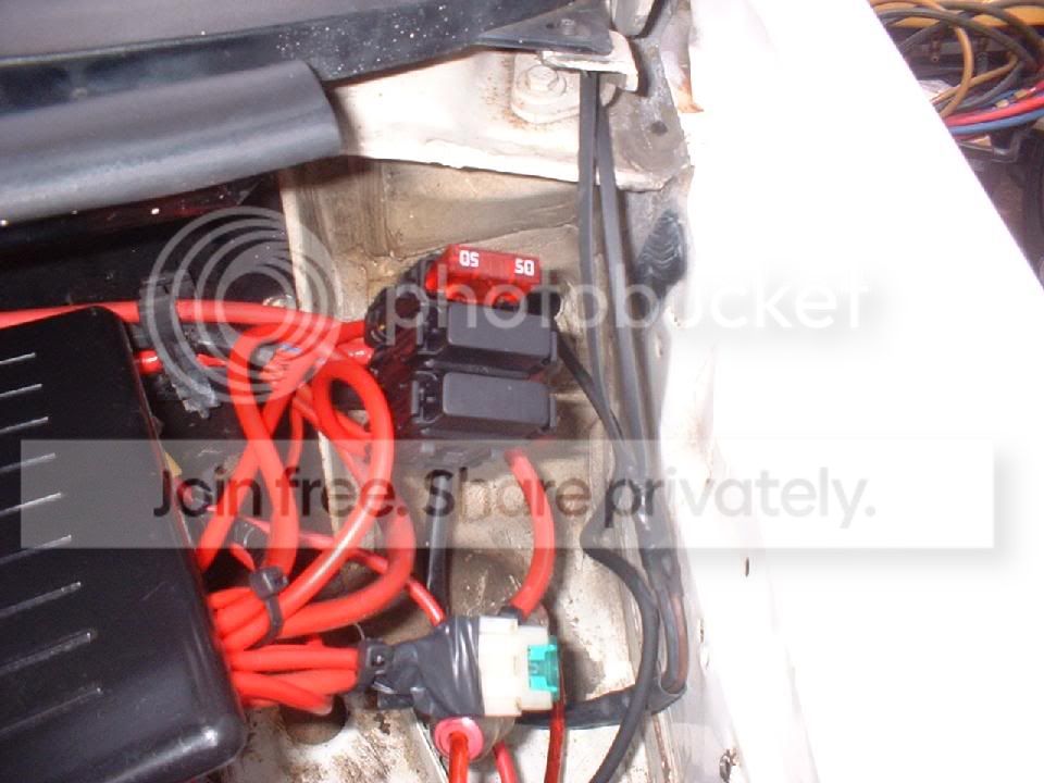

yes mate 3 of next to the battery when they get worn they cause low voltage problems replaced mine with 3 x 50 amp fuses

the terminal end goes on the battery and the other end is joined to a red wire which goes of into the loom this is x3
