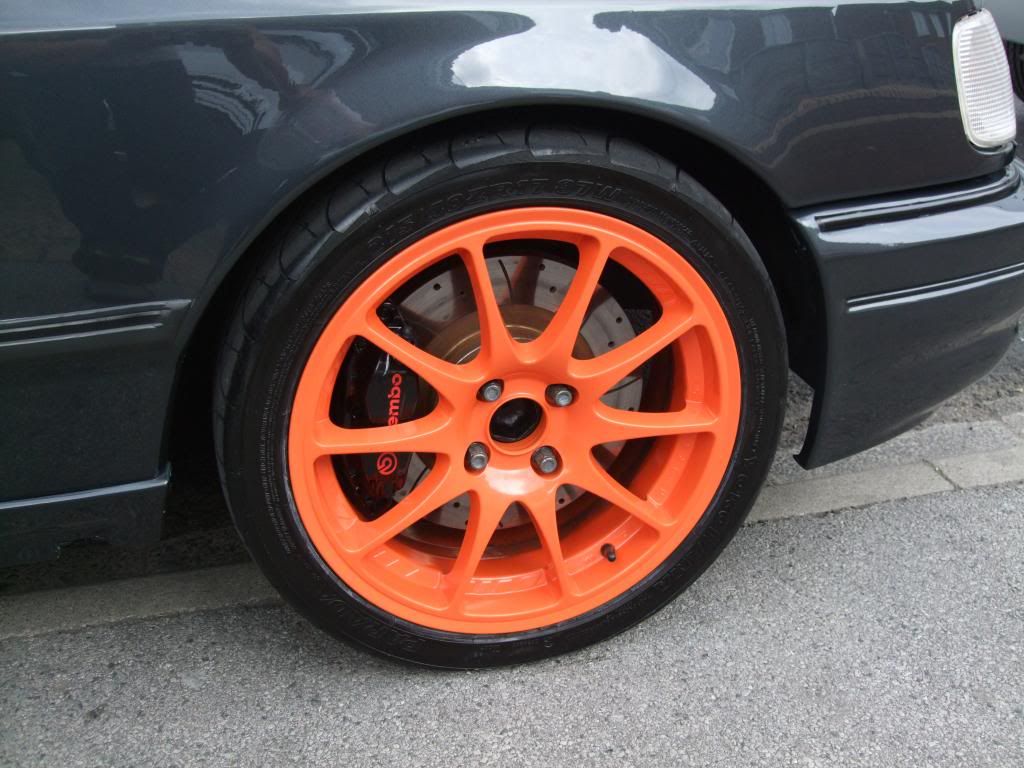

bmw e38 brembo with mk1 focus rs discs fitting kits are for sale on ebay

I called the guy who sells the conversion kits on ebay. He states they are only for 2wd and will not fit 4x4.when I called to ask why he was not very polite saying he though it was disturbing why I would even ask. Said to him I was just wondering what was the difference. Not very good customer service cos if I new why I wouldn't be asking. Strange bloke
