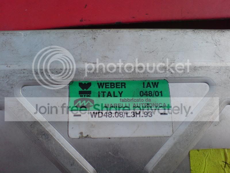

What ecu is this

Is it a L8 with a baby board ?

It`s a late model 4x4 sapphire L8 with Lambda control from the green top engine....

Oh and it looks like it`s got a std eprom in it too....

is that std eprom a good thing diva so good replacment for big turbo escort

It`s a very rare thing nowadays....
Yes
You will have to tell whoever maps it that you are running a Lectron valve though and not an amal valve......(the Escos uses a different boost control valve that works differently to the sierra one)

It may have the original eprom but the label has been removed from the window
and I bet its been erased and reprogrammed.
NO way of knowing whats in it for sure !!!!!!

as for the amal valve i have used a sierra one on my escort st one point and if worked just the same as the escort one.am sure stu said that they work in a different way and it should not have worked and the chip with the sticker on it says stg3 but cant see it in photo thanks guys
