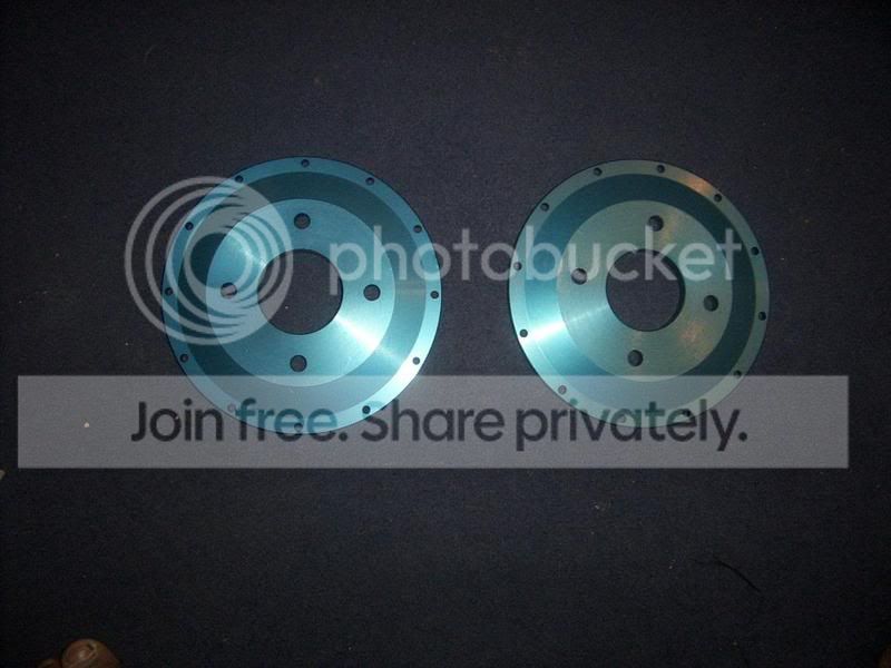

IS there a way of telling what make of discs these will fit etc!

they look to me like 2wd cossie bells for 330mm AP discs, some of which are 12 bolt fixing on a 203.2mm PCD

surely if you get the PCD of the disca and match it up with the PCD of cars you can find out that way.
but it wont fit all due to the PCD purely on the capability of the car itself.
but atleast you will know it will fit them cars!!!!!
