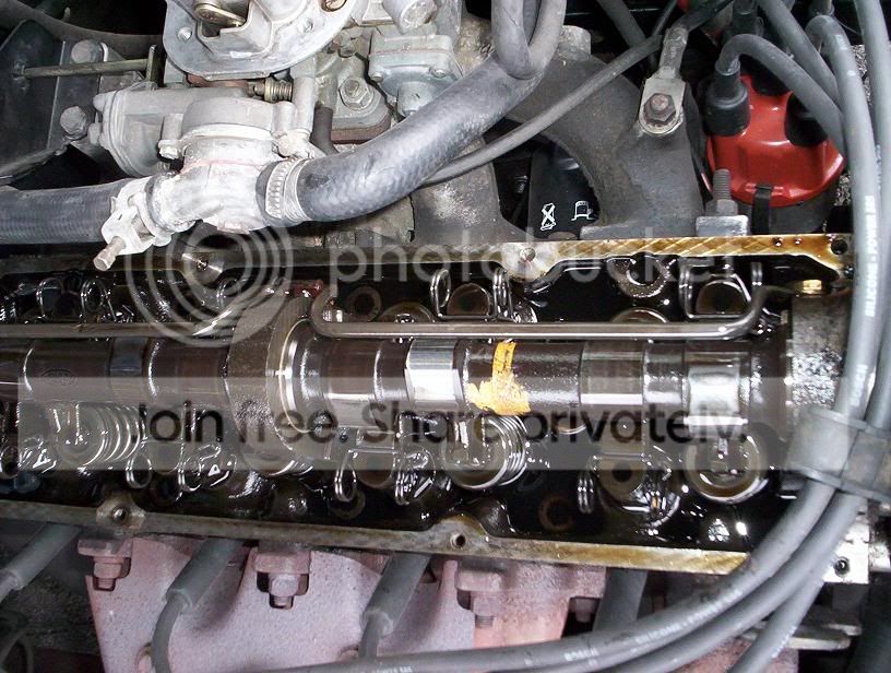

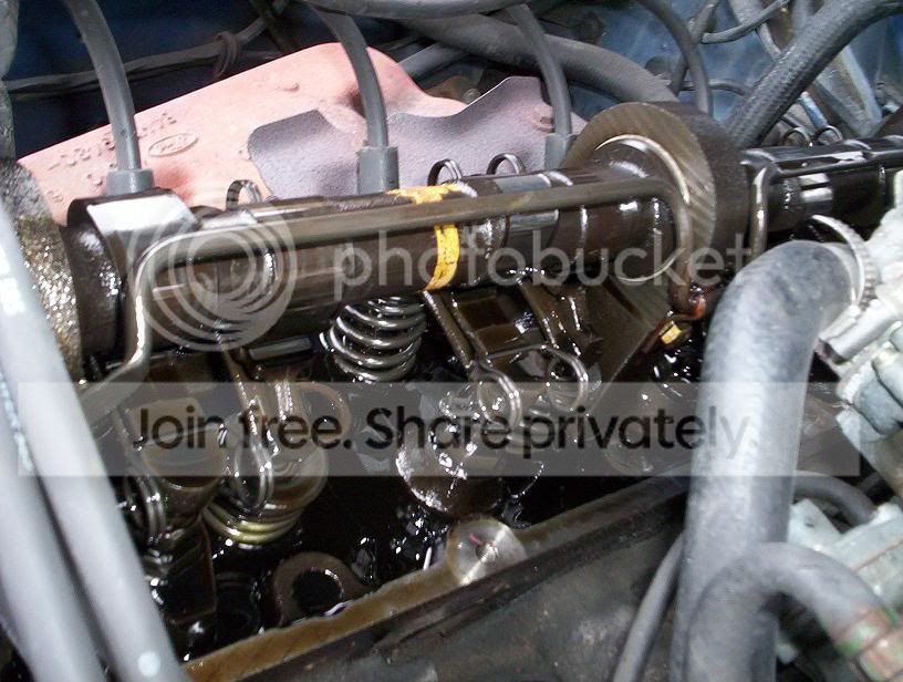

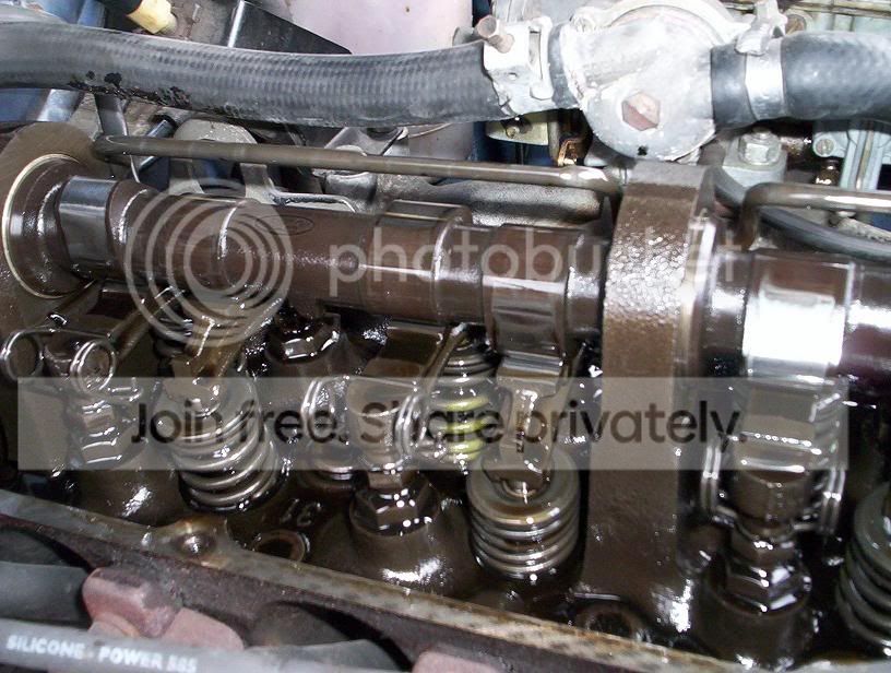

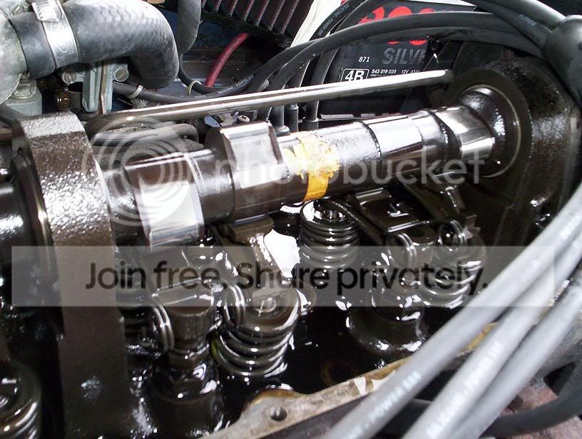

Is there suppost to be a pool of oil under the rocker cover around the springs?? like in my pics, and is everything normal here .

That looks perfectly normal, it's when you don't have any oil there you need to worry as the spray bars can get blocked if oil changes are neglected!!

correct as tab says-also available is a better spray bar for h/performance applications.prone to not getting enough oil to the front !!or was it the back???

I think it was any hole as the feed is from the centre outwards, there is a bar you can get with a tiny filter built in from, I think burtons ?
I always use FLUSH prior to any oil change so never had a problem.
