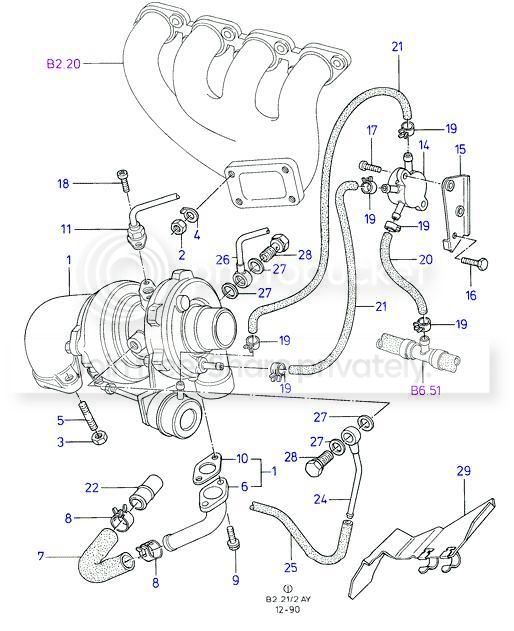

Does this have a gasket where the bent pipe bolts up to it?
Mine seems to be leaking oil and, as it drops directly onto my exhasust, this is obviously not good

so are you talking the end which bolts to the turbo with 2 x 13mm bolts?

yep, that end

Yes there is a gasket there (10), thought it was the other end of the oil return that was leaking on yours, the rubber connection to the block(7)?

As per the diagram above, there is a gasket

Damo at CSG sorted me one out yetserday. Top man
