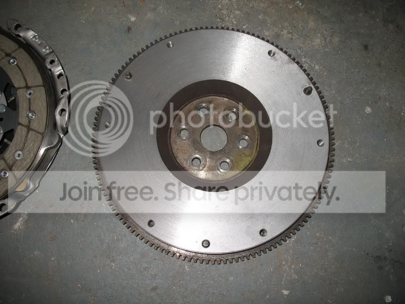

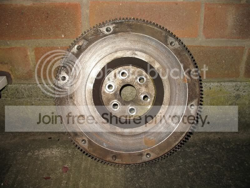

does anyone know if the MK4 escort XR3i FLYWHEEL originally had a recess for the clutch plate to sit in from new, or in other words is this a recess or just wear on my flywheel shown below...
only i have just had it skimmed, so now it looks like this.............
Old Apr 2, 2007 | 10:53 PM
SafeChav's Avatar
SafeChav
Posts: 13,798
Should be completely flat as it is now, this is the exact reason for skimming flywheels
