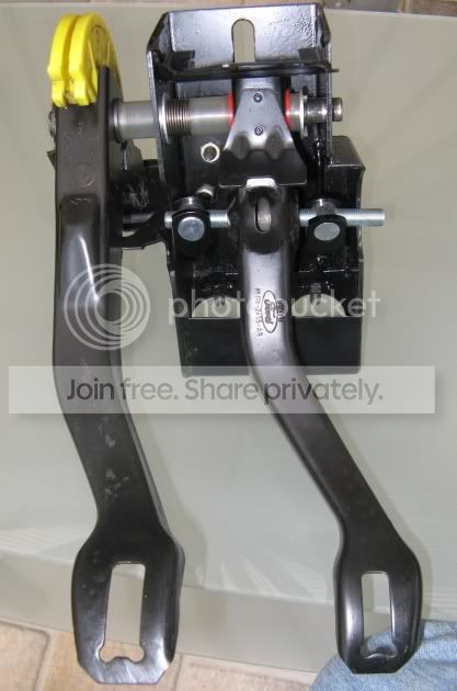

Pics as promised.
Standard Sierra pedal box supplied to us for modding/conversion to bias box. All other components supplied with it but not photographed. IE Master Cylinders, Fixing Kit etc.

Just the pics i was after. are the master cylinders on the other side of the bulkhead?

Thanks looks good .Ive managed to fit a universal bias box in the engine bay rite behind the pedels it isnt quit finished but ill post some pics when im done
