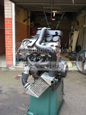

Nothing interesting I'm afraid. I design traffic signals for a living!
I'm just a bit of a petrol head. Started with building crunch 90 track bikes as a kid (mine had high comp, re profiled cam, pocketed piston, homemade oil cooler) and gone from there. Picked up a lot of stuff along the way i guess. Try to have a winter project every year.
Heres one from a few years ago! My Blade flew after i put this back in
This years project, the kit car, isn't doing to well due to lack of time. Been working on other peoples cars (like the BMW) and busy with my small side business.
www.suffolkflockingservices.co.uk
Just lets me pay for my toys with out the missus moaning really.
Doug.
